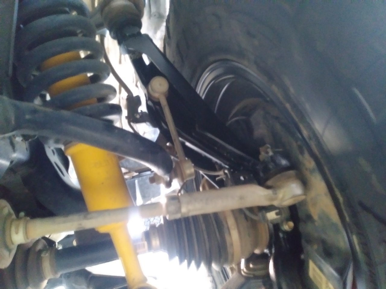

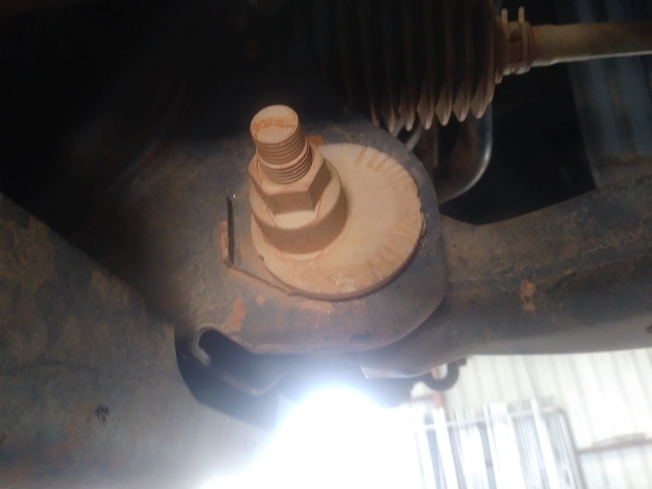

    Had Milo the Great install the Total Chaos cam tab kit to fix what i broke.
    Now: 20210719_170412.jpg
    Also got my spindles gusseted
    Annnnnnd finally got some Wheels and tires put on.
