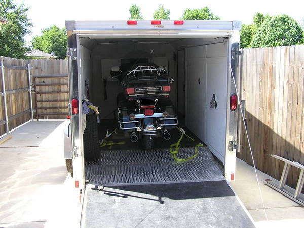

    I pull mine in a trailer anymore. However hauling, I use a 4" X 4" piece of wood mounted to a piece of 3/4" plywood about 12" wide. This combination is about 2' long. I place this under the frame sideways and then snug it down. This is with the front wheel in a chock. This helps stabilize the sideways rocking without overly compressing the front forks. I also tie off the rear to keep it in line.
    You might also place a piece of plywood on the tailgate for reinforcement as I just notice you've got a DC and the rear tire is probably riding on the gate? The above method would, if shimed to your bike, reduce some of load on the gate.
    Kinda hard to see in the picture but you can get the idea.
