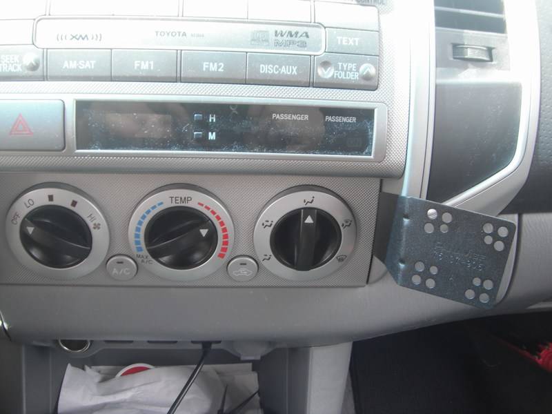

    I picked up a dash based mount for my Xoom. It came yesterday and I installed it.
    It's the padholdr RAM dash mount for the 2nd gen Tacoma. Works for most 10 inch android tablets and also iPads.
    Slip out your environment control panel. A thin small flathead screwdriver works or anything with a thin edge you can pry or wedge it lightly with. There is a clip at each of the 4 corners that holds this panel in place and it doesn't take much force to pop it free. You don't need to worry about unhooking anything else.
    Pull gently on the wiring to get enough slack to let the panel hang free of the opening where the dash mount will be installed. Position the mount bracket, which is specific to the model of vehicle you're mounting it in.
    Screw it into position with the supplied self tapping screws. A power screw driver or drill makes this much easier than doing it by hand.
    Put the control panel back in. It just slips in. There's a little binding with a tab on right most part of the control guts that rubs against a screw head. It's not enough to stop it from going in pretty easily, but is something I'll probably file down a bit for a better fit.

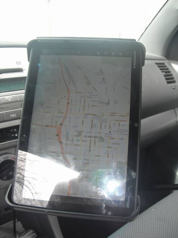

    Here it is all mounted up for GPS navigation and such.
    You could just as easily pivot it horizontal if you prefer.
    From the driver side, all the dash controls are still easily seen and reached. It doesn't infringe on the passenger space either though it does block some of their access to climate controls.
    By default, the arm mounts with hex head screws and bolts on the back. I'll probably swap those out for some thumb screws and wing nuts so its easy to mount tool free.
