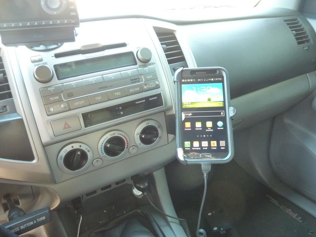

    Is the mount directly attached to the clip for the phone or are you using a ball mount?
    I'm thinking of going with a slip grip for otterbox defender and a panavise mount to attach to the truck.
  6. Jul 7, 2013 at 11:03 AM
    Rt1Box92A
    Rt1Box92A Well-Known Member
    Jan 6, 2013
    #94607
    164
    Jim
    Escondido, CA
    2010 PreRunner TRD Offroad

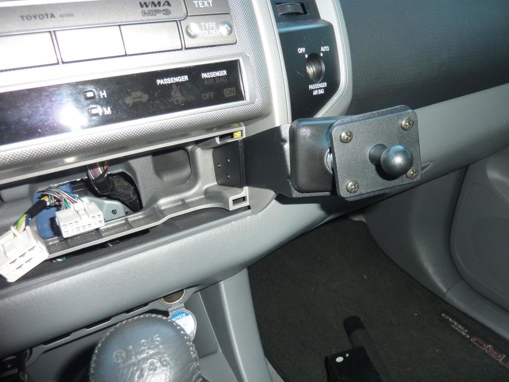

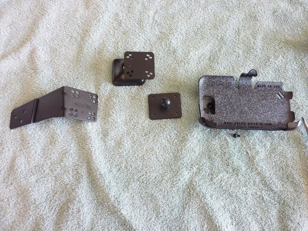

    The primary Panavise metal mount has the standard AMPS bolt-up pattern and screws in the dash behind the AC controls. (I also used double sided tape along with the screws. Note the gap in the dash is slightly larger than if I would have just used the screws alone.)

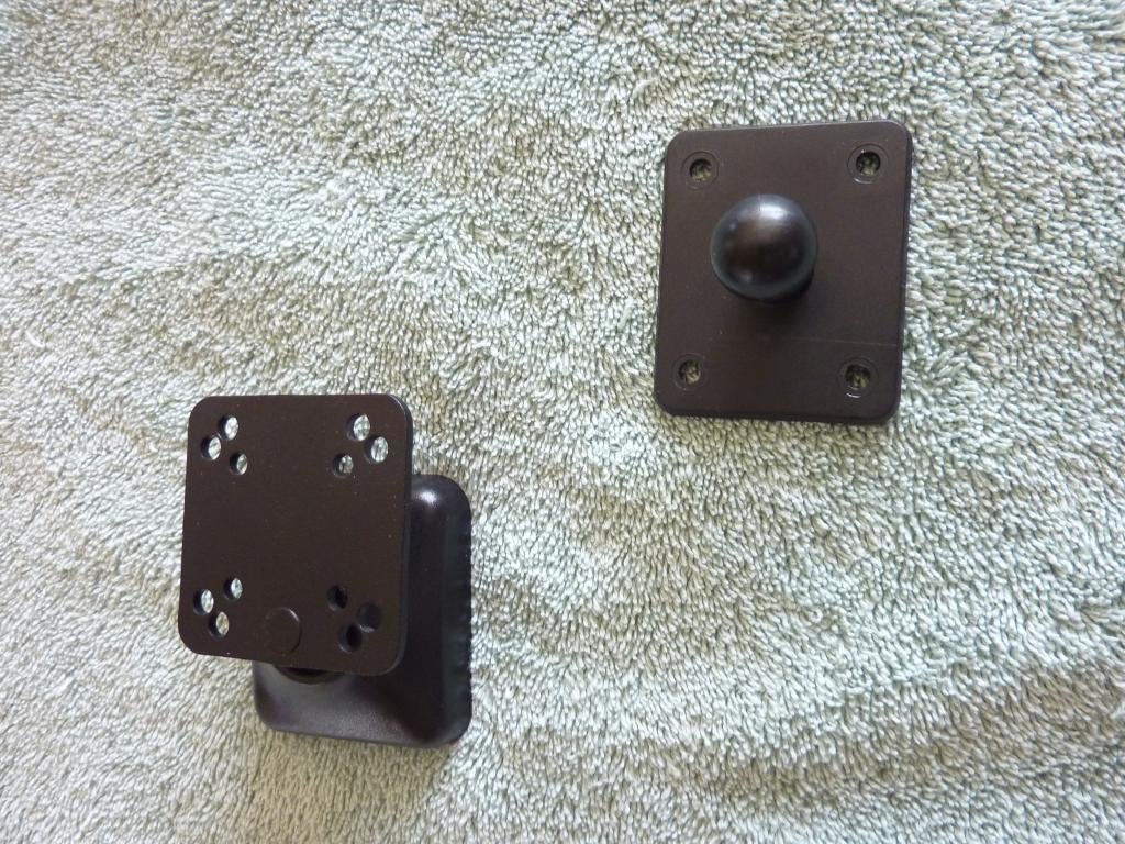

    I wanted my phone to be very secure, but more maneuverable (angle wise), so I used a Panavise 'offset tipper base' (AMPS pattern), and then the Arkon 17mm Garmin ball plate (again, AMPS pattern). This setup now has two points of pivot; the first at the tipper base, and the second at the Garmin ball to the SlipGrip
    In hindsight, the 'tipper base' piece really wasn't necessary, but I still recommend it because it pushes the phone away from the dash just the right amnount. (Note: I did try all of this using RAM Mounts 1" ball system w/ short 2.5" arm, and the result was ugly, way to large, and semi- floppy on bumps.)
    And, the SlipGrip totally rocks.
    Hope this helps.. Jim
    http://www.amazon.com/gp/product/B000I7RUFI/ref=oh_details_o07_s00_i00?ie=UTF8&psc=1 (fits up to 2011; unknown if after that.)

    No, that is RAM Mounts 1" diameter ball (RAM is a very good brand and an excellent mount system http://www.rammount.com/)
    I used a 17mm ball, commonly called a Garmin (GPS) ball because the rear mount is a ring that tightens like, say, a bottle cap; the tighter you screw it over the ball, the more solid the mount.
    RAM mounts use a 'pinch system' that clamps on to the ball, with the only disadvantage that the clamps (called 'arms' by RAM) tend to be a bit to long for the small cockpit space of the Tacoma.

    So how do you connect the male ball of the AMPS ball to the male ball of the Slip Grip? Is there something I am missing like a female part of the Slip Grip??
  12. Oct 22, 2014 at 8:29 PM
    Rt1Box92A
    Jan 6, 2013
    #94607
    164
    Jim
    Escondido, CA
    Welcome to TW
    You are correct; the 'Slipgrip' I used has the female portion 17mm Garmin ball mount.
    AMPS refers to the "industry standard" hole pattern used for mounting screws. IDK much more than that...
