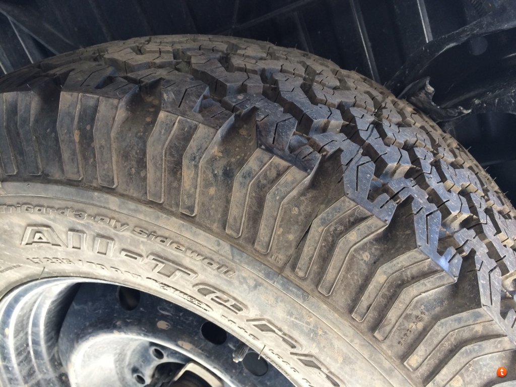

    Finally got a 285/75/16 mounted. It's not rubbing the diff or exhaust, but it is way to the driver side rubbing. Does this matter?
  16. Aug 12, 2015 at 8:01 PM
    #16
    oly kenji
    oly kenji Well-Known Member
    Jun 17, 2014
    #132165
    362
    Seattle, WA
    2014 DCSB OME, Soon to be 35's Group Buy Builder
    Also, with the chain fully torqued in place, the wheel seems to lean too. It's a little crooked...
