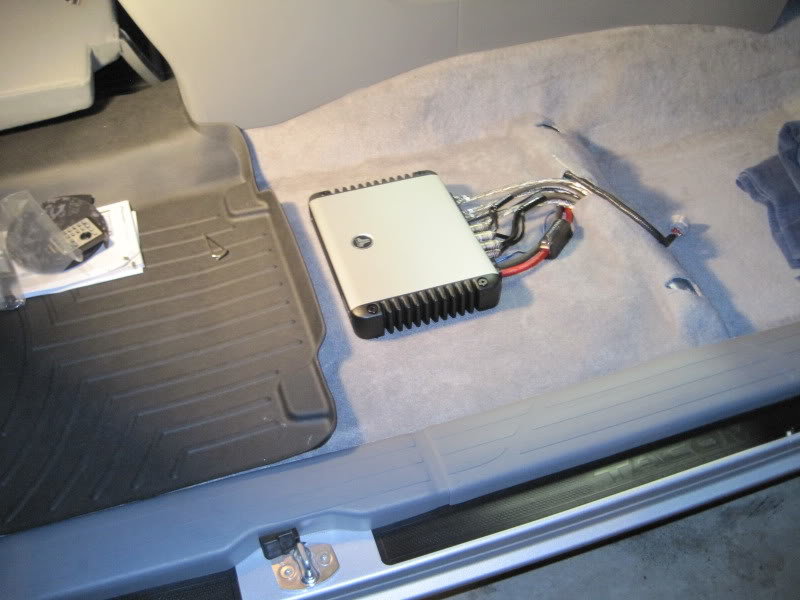

    Another option is to cut a piece of 1/2" mdf, plywood, whatever, to fit the area under the seat. Slip it under the carpet, so it sits between the floor of the truck and the carpet. Now sit your amp on the carpet where you want, and screw it down. You essentially sandwhich the truck carpet between the amp and mdf board.
    Amp won't move this way, and also provides another flat mounting surface. I did this method after a recommendation from Mr. Marv, worked great in my install.

    A pic of the wood in action.
    "Can't see the lines can you Russ?"

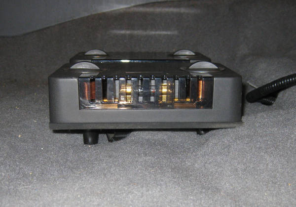

    This is how I mount stuff under my seat...go get some 2" velcro and put the strips lengthwise on the bottom of the amp, just the velcro part that sticks to stuff, then just place it on the carpet, I have the boss 1200 held down like this and I have to take the seat off to move it. Italyn has tried to move this sub so he knows how solid it stays.
