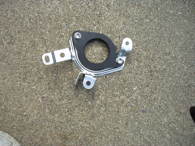

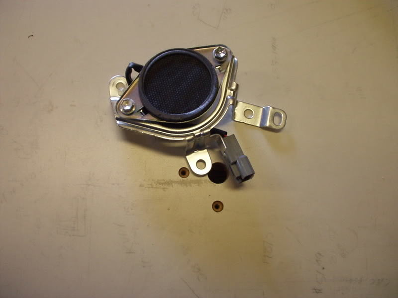

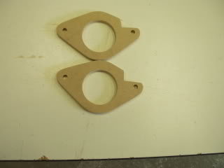

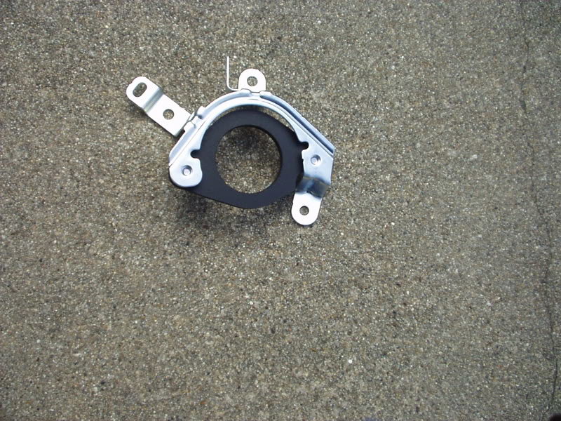

    Below is how I do it using 1/4" MDF. You'll note that there is a notch on one side and that it is mounted to the BACK side of the original bracket. This is done to allow clearance between the new tweeter and the door panel grill as some tweeters protrude more than the factory speaker. :)

    2
