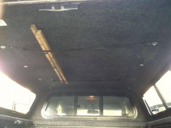

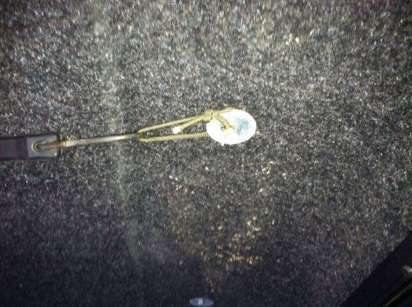

    Mine is an ARE. The flat part of the roof is thicker. I have bolts though for the gutters that hold the roof rack on. I have attached a bunch of bungees to the bolt and hold kayak paddles and fishing poles up there. I will look for pics.

    I've added them to all 4 on each side and crisscrossed them!
    Just some paracord.
    And my car alarm mount

    You can see on my roof that the middle section is thicker. I have been thinking about using some really coarse thread wood screws to mount something there.
