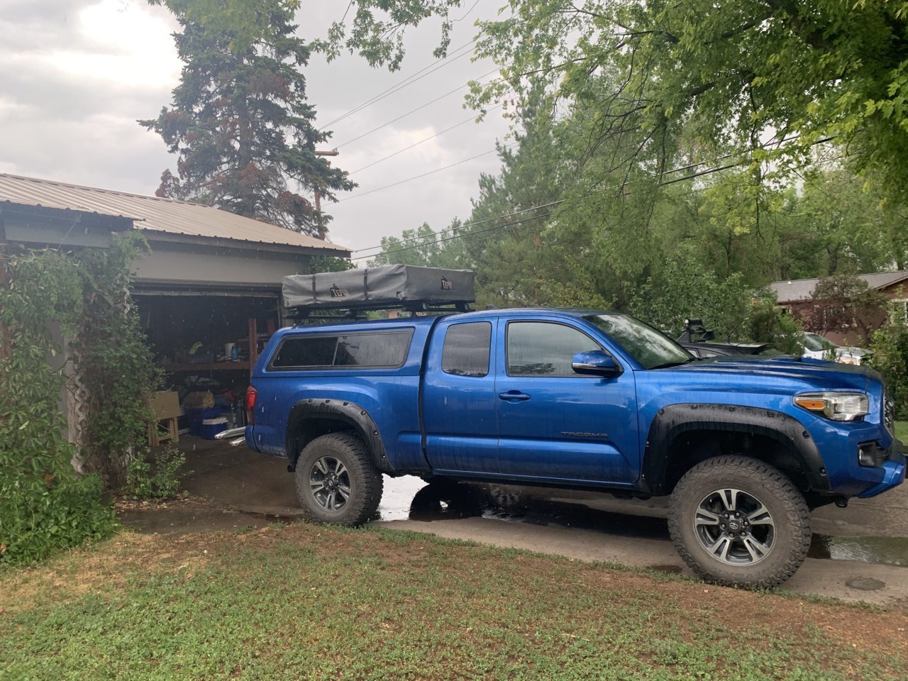

    I recently picked up an ARE CX HD. Cap looks great, fitment is beautiful and it looks sturdy as hell with the subframe. I'd like to mount my Tepui Kukenam 3 to the cross bars but low and behold the crossbars sit way too far apart. They are bolted to the frame of the thing so cannot be moved. I have an ACLB so the cross bars sit 54.5 inches apart from center to center. Clearly a dumbass move on my part for not doing my research on fitment, but that's par for the course. Sneers and Jeers expected.
    I've search through a dozen or more threads to see if anyone has figured out a solution to this that doesn't involve dropping a grand on a platform rack. Even if I decide to bite the bullet and spend the money, all of the platform racks I can find seem designed to be mounted in a yakima/thule channel, not atop a fixed crossbar.
    Long and the short of it is I have a couple questions that I hope someone can shed some insight on:
    1. Any ideas on what to use to build something myself that could bridge the gap between the crossbars and spread the weight out evenly? Spitballs and wacky creations are welcome!
    2. Are there platform racks that can be attached to a fixed crossbar with this width? Preferably in the $500-$700 range but i'm willing to hear anything.

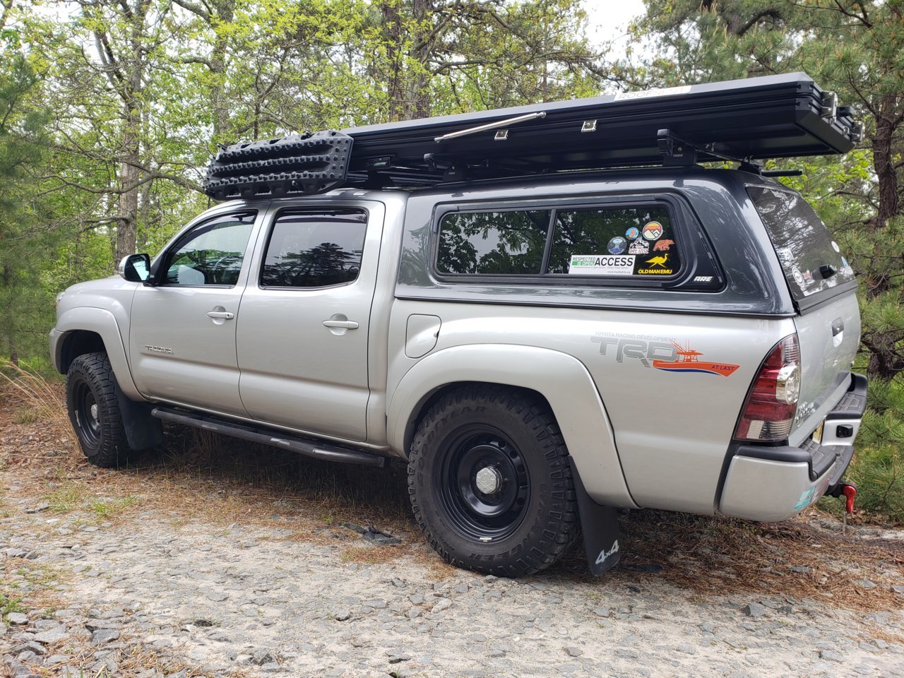

    Can you post a pic of the setup? I have my tent mounted to my cap and it sounds like the measurements are similar. The front of the tent rests on some rubber gasket material I used and has about 1" of clearance when the body flexes. I haven't had an issue with it and everything is secure.

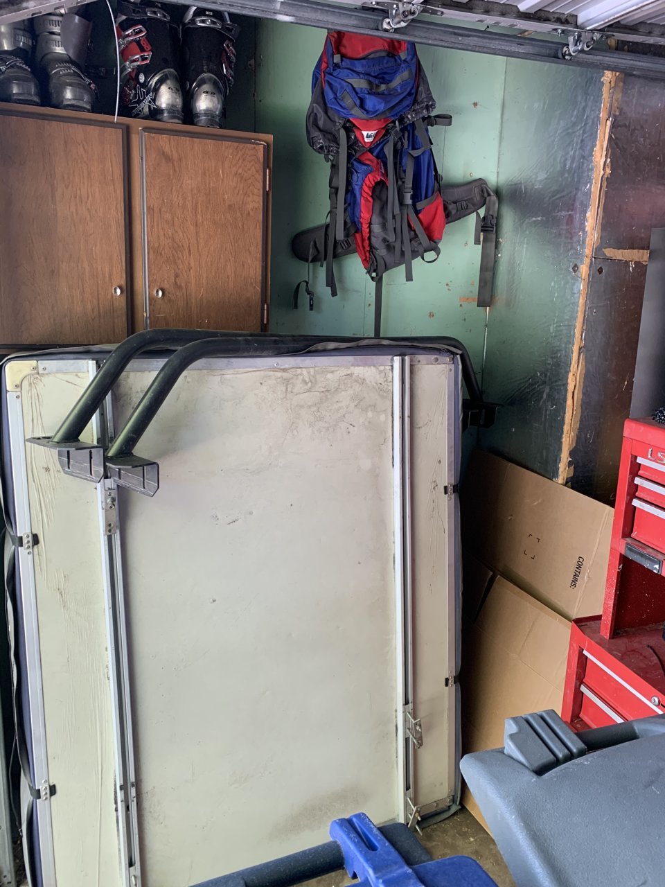

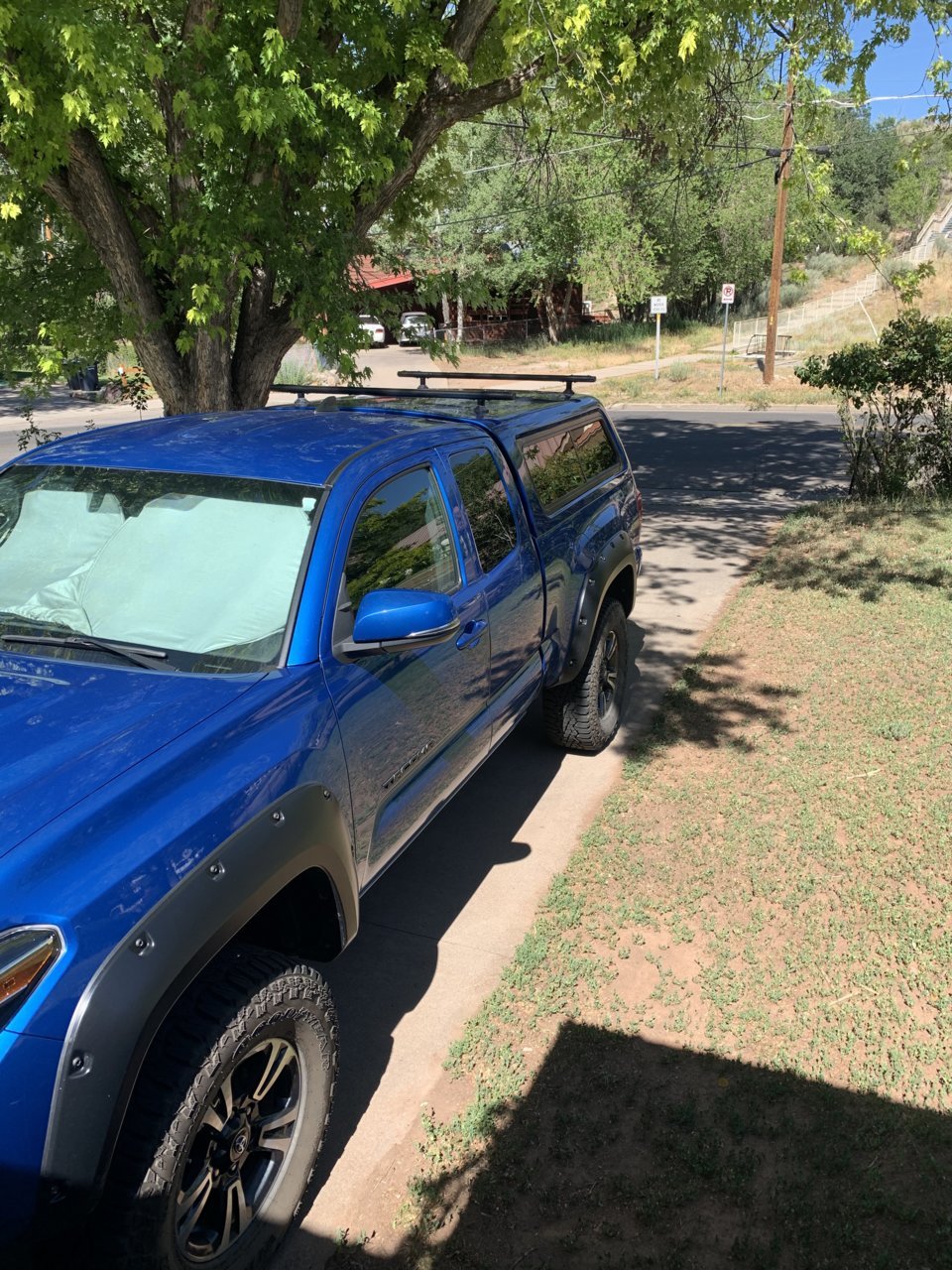

    wow that tent is a beast! Like your setup a lot. Pics of the crossbars and the tent rails is attached. my softshell tent is much smaller than your rig, so the spread is the issue as the manufacturer recommends a max of 48” spread between crossbars.

    could you take the bars off the mounts and have them go front to back on the sides? rather than side to side how they are now?

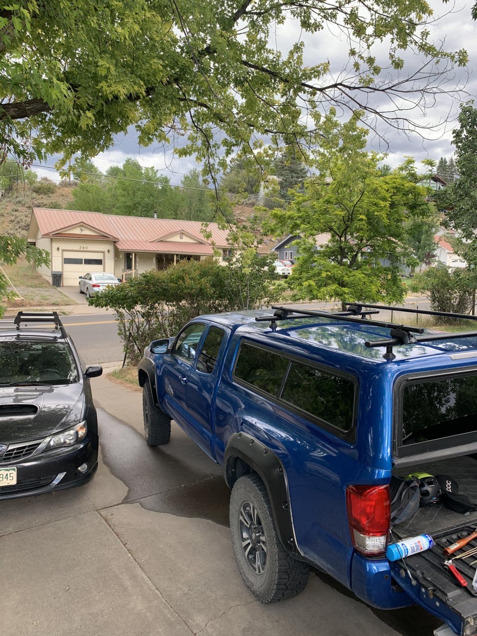

    Update:
    @NV_Spencer next time you’re in Colorado I’ll have to buy you a beer.
    Yakima round bars attached to the ARE rails with timberline towers. Flipped the Tepui tracks to run width ways rather than length. Sits a bit tall but it works.
