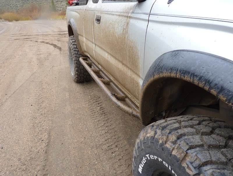

    I had mine mounted slightly at an angle to give better clearance, but they don't stick out far enough to be a concern. I wouldn't worry about getting in and out of the truck. You'll get used to it. Shouldn't wheel without them IMO.
