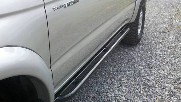

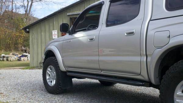

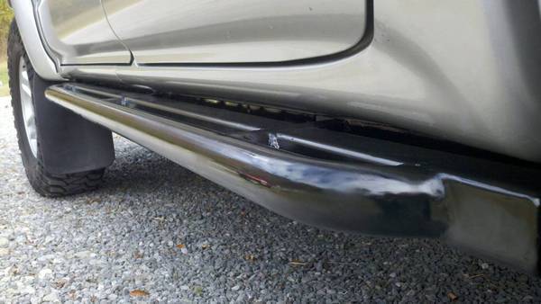

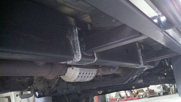

    I didn't want a slider that stuck way out either so I built my own..2x2 3/16 square with 1 3/4 round.

    Wow, those look good. Nice job:thumbsup:

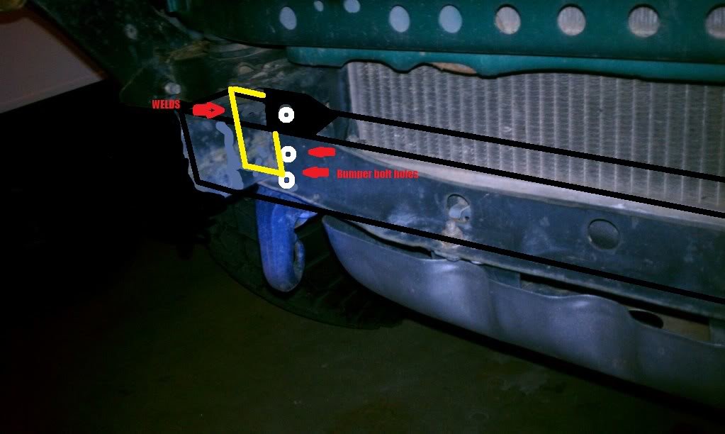

    So im guessing through that hole between the 2 studs there is the b olt that will take out the cross member that the skid bolts up to??? my MetalMiller skid bolted back up to the same place the stock on did but for my bumpers new cross member to be welded/bolted up that flat piece with the studs across the crush cans had to come off and the new cross member was tight around the cans and welded up around the ends of the cans and connected to the frame...ill paint a pic sometime here in a few
    Hopefully my pic makes since..but this is basically how my new bumper cross member is welded up...45acp will know exactly what is going on from looking at his...

    Yes cut the stock on out but kept the one for mounting the skids and added a new 1/4" one that the bumper mounts to and down the road im going to probably tap some holes in the new cross member for the skid to bolt up to.

    I agree. Nice looking sliders, Hunt.
    Truthfully, that's all I'd need for the type of wheeling I do.
