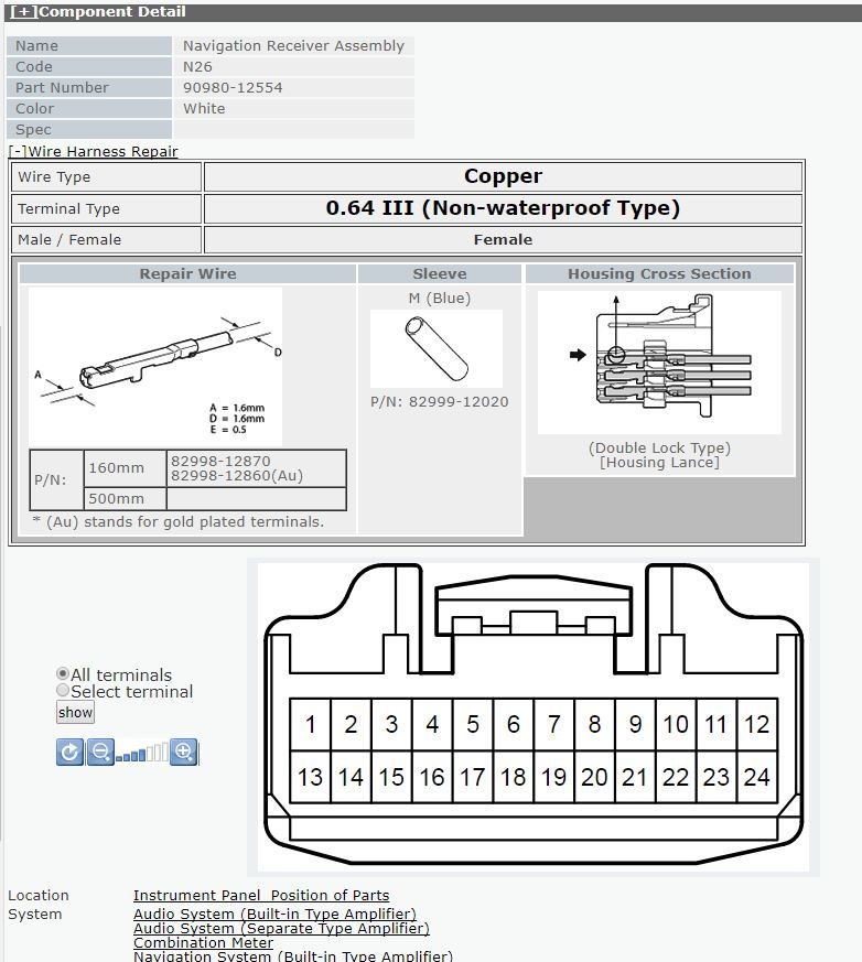

    Here's an N26 connector and pins from a 2017 Tacoma

    I ended up buying a wiring harness from ebay, I couldn't stand the backup camera being in the mirror as it was just too small.

    did you harness swap or do you have it in the mirror and HU? I find I still use the mirror more. I wired it up like this post so its on both HU and mirror.
