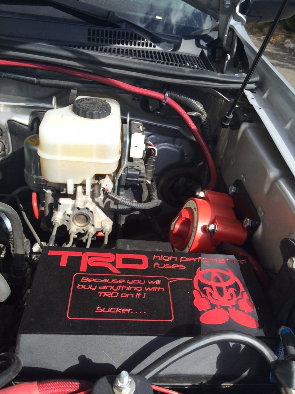

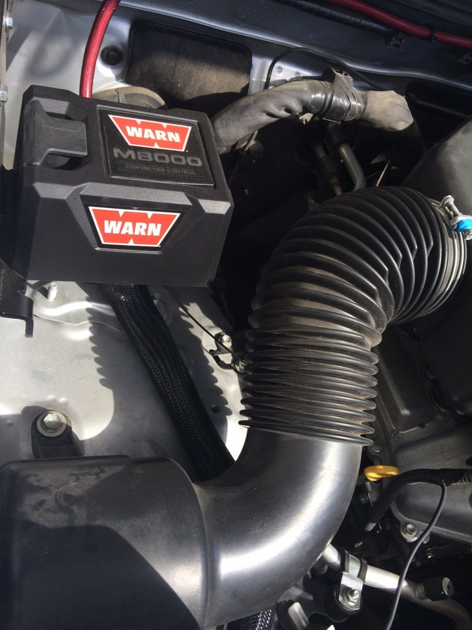

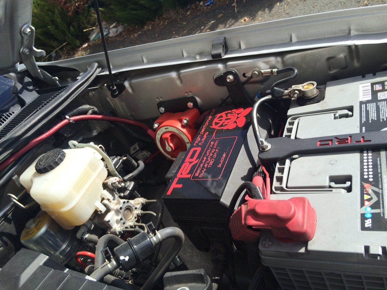

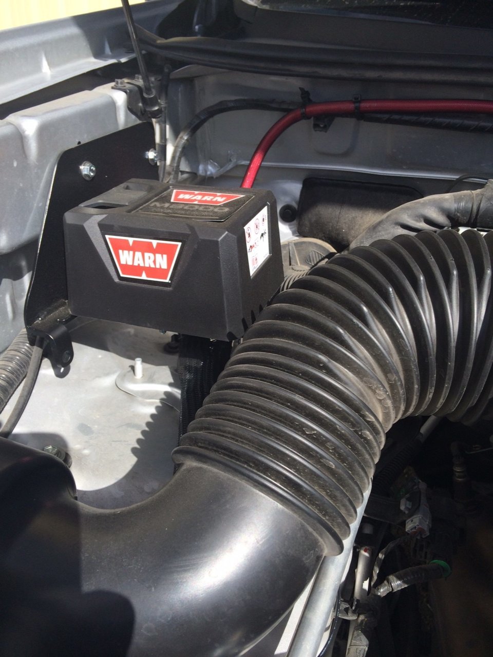

    Here is my winch setup under the hood. Just to give you options.

    Damn that looks cleeeaaaan! My entire winch configuration will be built into the bumper, so I'll probably try to find a place in there to mount it, if not i'll bolt it up near the battery.
