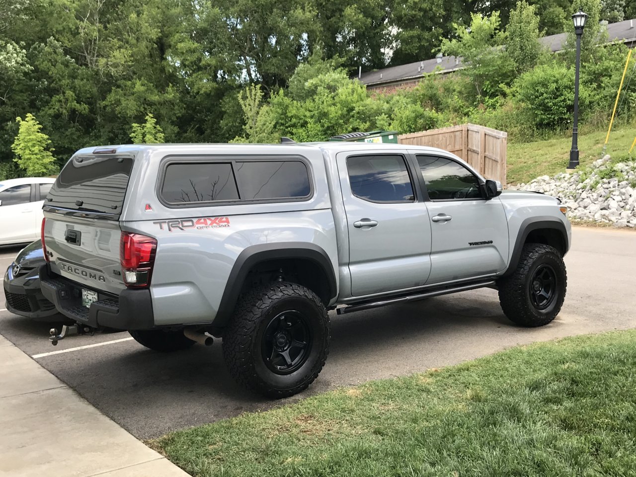

    Kings 2.5 front/rear, ICON RXT, RR2-s, 285/75/17 KO2
    6112s, Dakars, SPC UCAs. 285/75/17 bfg KO2s. Love mine
