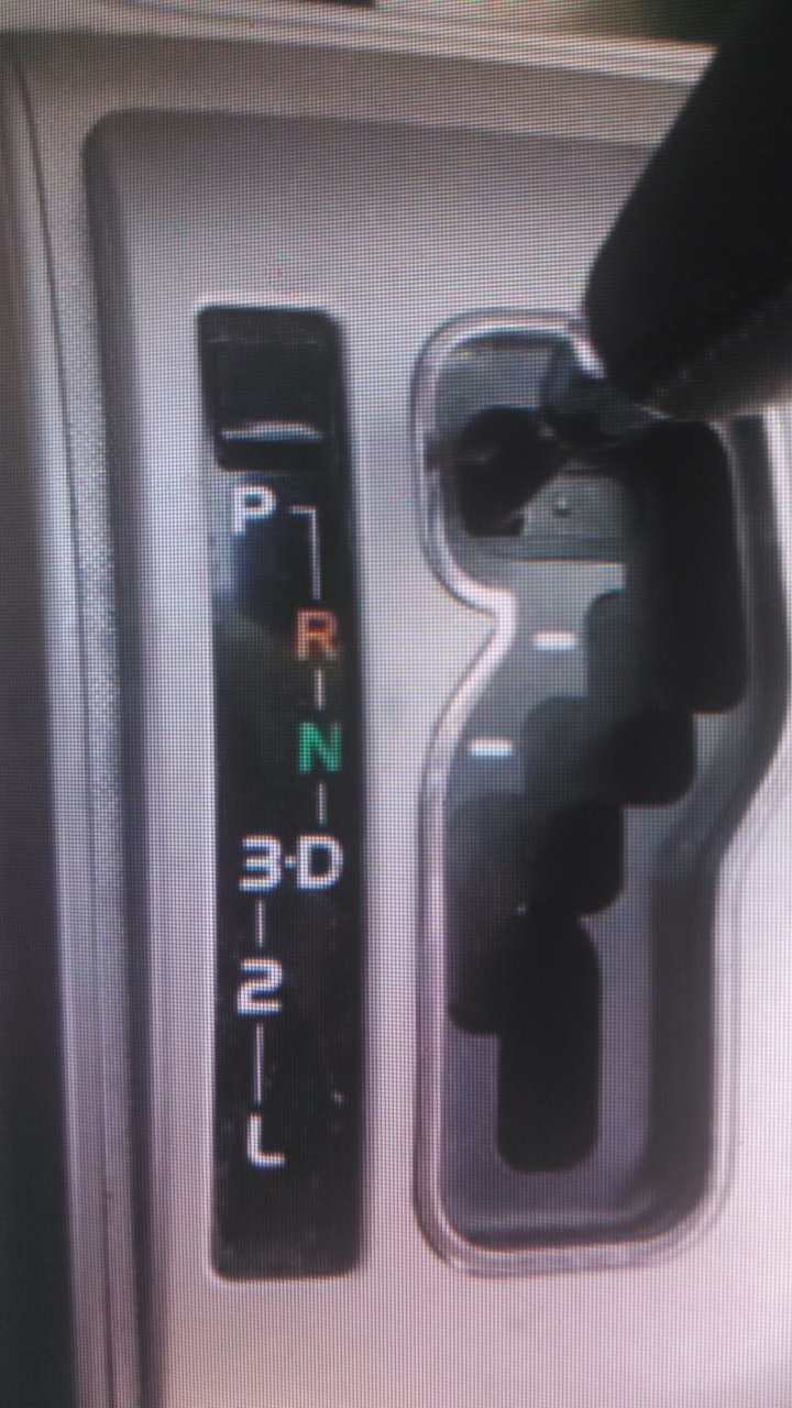

    I checked the transmission fluid, it's good. From what I can tell its a stock truck, no lift, it has stock size tires on it 245/75r16. That was my thought too; why would someone re-gear a stock truck? Unless they were intending to lift it and never got around to it, idk. This a picture of my gear shifter and I don't see an overdrive anywhere.

    Yep, just like my 2013 shifter. the "D" is your OD, mine isn't marked OD either.
