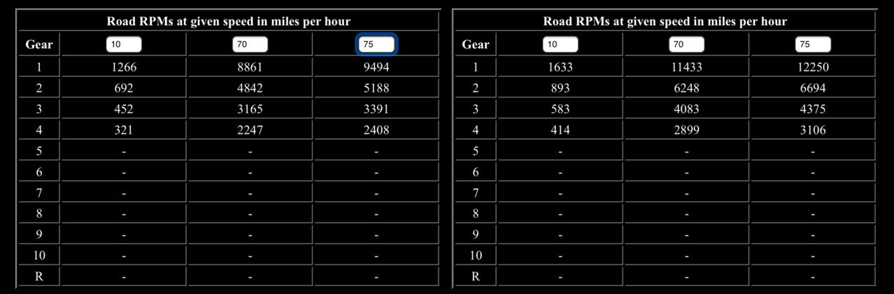

    OP, you need to jack the truck up and see what gears are in it.
    Turn the wheel and see how many times the drive shaft turns.
    Left is what STOCK should be . Right is what 5.29 would be.

    OK thank you very much for that gear chart. From what I'm seeing my mph is very close to the 75mph in 4th gear pushing 3106 rpm's. Actually mine appears to be doing a little more but that could be calibration. I apologize for the burry photo. I'm just shy 75mph and right around 3100 maybe a little more.

    I assume a 5.29 is an after market gear? Geez a 5.29 seems to be a pretty low gear to me.
