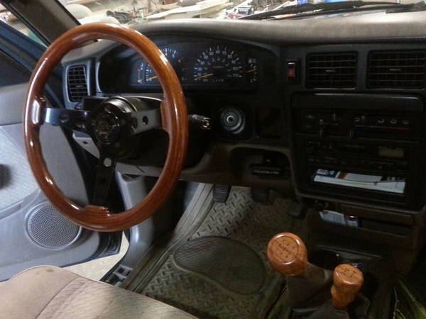

    Hey man, just wanted to give u some props. I haven't used this wheel in over a decade, but, thanks to you she's back in action! I also went ahead and turned some shift knobs just to tie everything together
