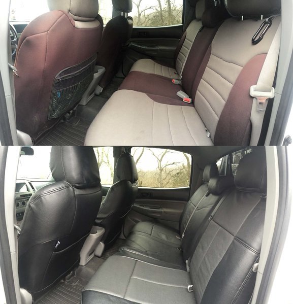

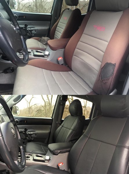

    Snagged some "new-to-me" Clazzio seat covers to replace my 8 year old Wet Okoles. There are a couple places that I need to tighten up but overall, these are wayy better than the WO's.

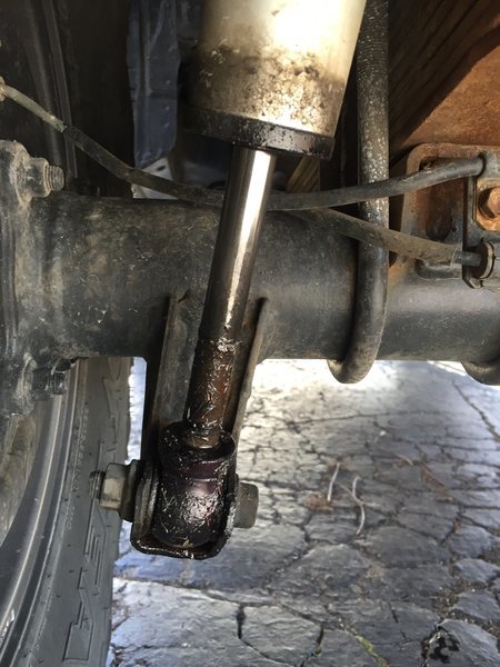

    Don't you just love the little surprises you get when you do your maintenance? Wasn't planning on replacing shocks anytime soon...

    Same thing happened to mine. Bought a simple rebuild kit for under 25 bucks at mckenzies.com and had the local TW shock guy rebuild it. He had it done in less then an hour.

    Yea I am going to have to find somebody up here that can do that or I can learn how, lol.
