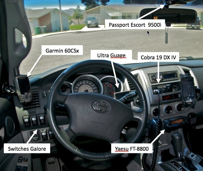

    When you get to mounting your new CB. Can you please take a few photos of your old dash set up from the rear. I am in the process of installing my Cobra 19 in the place where you had yours.

    I upgraded my radio to a Pioneer AVH-8400BH and with it being a double DIN, it gave me the excuse to go ahead and get a Cobra 75WXST CB radio. I also moved around a few items and cleaned everything up a bit.

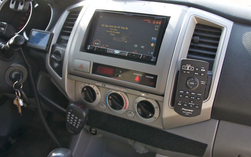

    First photo is my old setup.

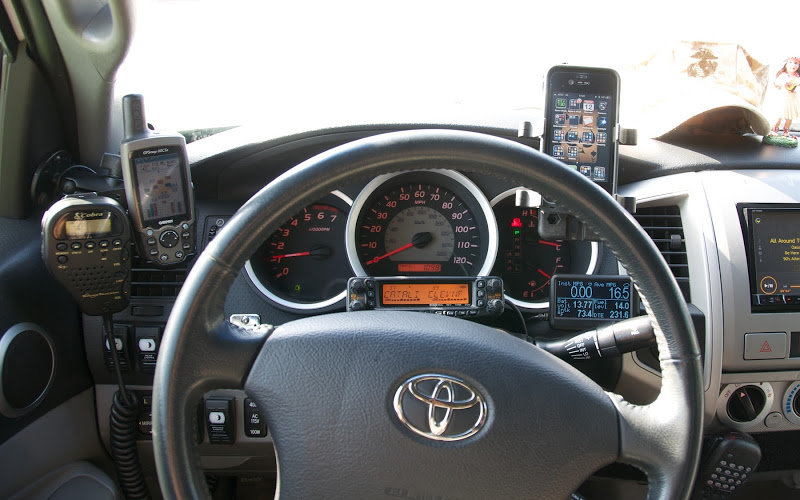

    This is the new setup. I wanted everything within plain view for the driver.

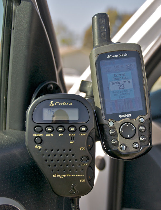

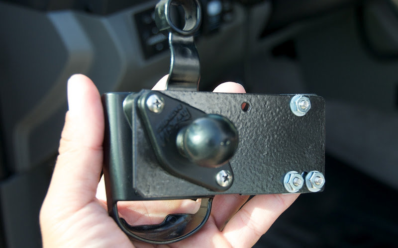

    The 75WXST was mounted next to the Garmin GPS. I used a piece of flat metal from the hardware store and mounted the mic holder up.

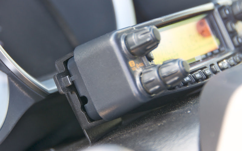

    The Yaesu was also moved up on top of the steering column. I used two l-brackets that costed $.60 from Lowes and painted them black. For the mic, I put velcro on the back and mounted a velcro strip below the AC controls.
    Here you can see the velcro strip and the super nice 8400BH. THe velcro strip also covers up some holes that were drilled into the plastic. Overall, I am loving the new setup.

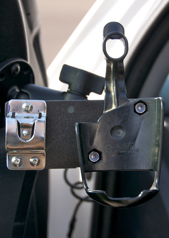

    Front of plate with the mic holder for the 75WXST. The mic holder I got off of ebay. The mic won't fall out when you are out on the trails with this holder.
    And here is the back.
