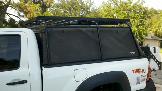

    Funny that you say that...The cap is currently for sale on craigslist. I am looking to put a soft topper on it and eventually go with something similar to what TRDPARTS4U has on their truck. The topper is great but I need something that can be taken down easily plus I would like to add the external rack portion for a RTT. Trying to get my hi-lift out is a PITA with the topper. It is currently on mounts inside of the passenger side of the bed.

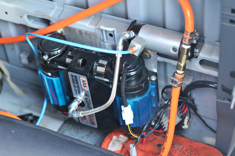

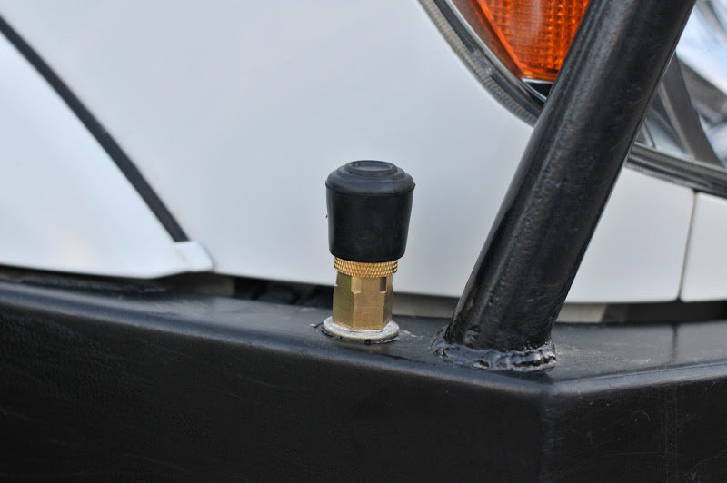

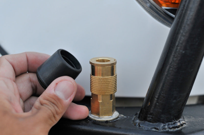

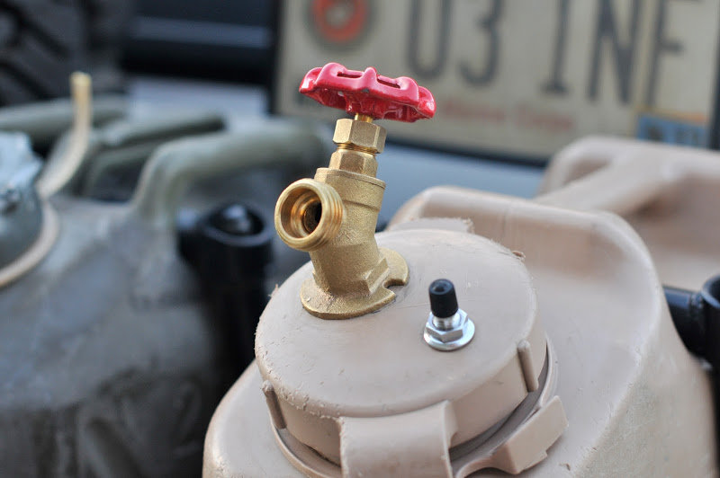

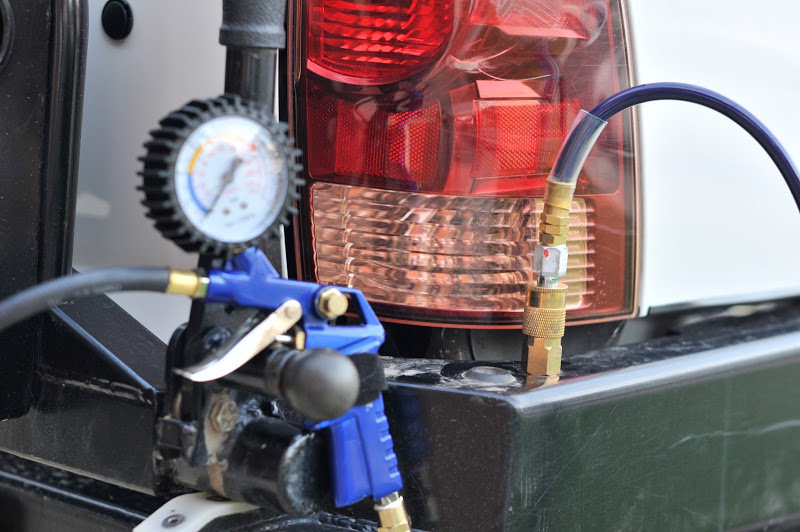

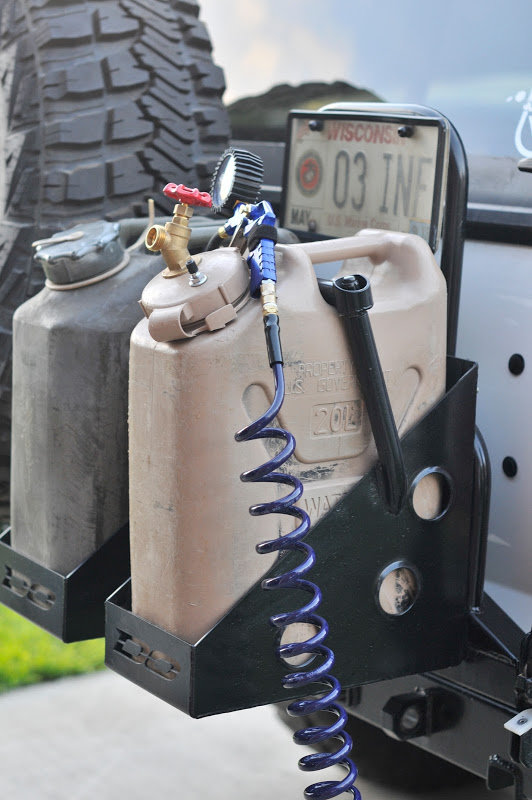

    On-board air system about 90% complete. I want to add a tank later on down the road. For now, this setup can fill 1 35" tire from 0 to 35 PSI in 3 minutes. I have one quick disconnect at the rear bumper and another at the front bumper.
    Front disconnect
    Rubber chair doo-hickeys for covers
    I am going to clean it up a bit in the next week or so
    I also in the works of completing a pressurized water system for my scepter water cans. I am about 75% complete on that project.

    Made a video of the pressurized water can. I am a photo guy, not a video guru so forgive me on the video. This wasn't a Spielberg setup...I had to record some audio in so you won't be able to hear the compressor run.
    This is a pressurized water can that can be used to wash dishes, spray off sand, take showers or whatever you may need. Items used:
    -Scepter Military Water Can (MWC)
    -spigot with a 1/2" female end
    -male to female 1/2" adapter
    -1/2" PVC pipe that was cut to 18"
    -Screw on type Schrader valve
    -Compressed air source
    http://www.youtube.com/watch?v=POrNzl0wqXI

    i like the pressurized water can, but wouldnt it be better to have a smaller diameter hose to make the pressure seem stronger? other than that it looks great man, your truck is and always has been my favorite. :bowdown:

    I could put a smaller hose on but it has plenty of pressure as is.
