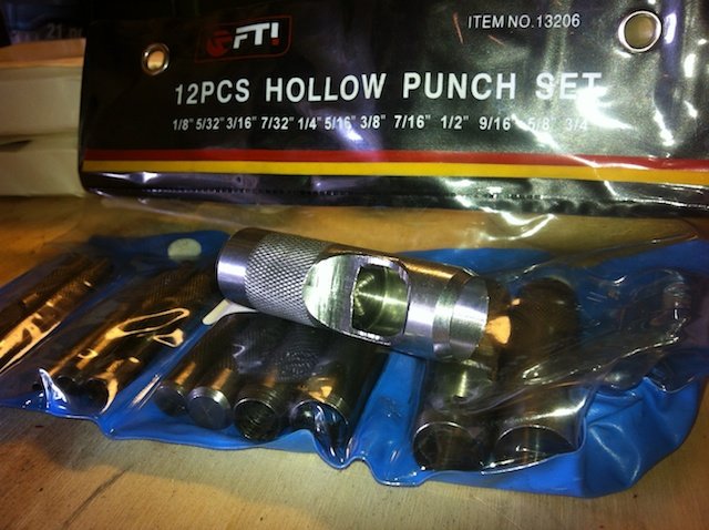

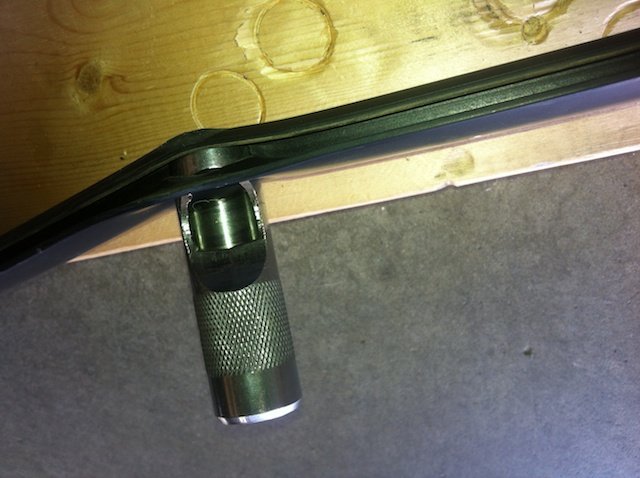

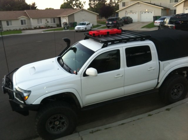

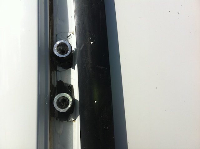

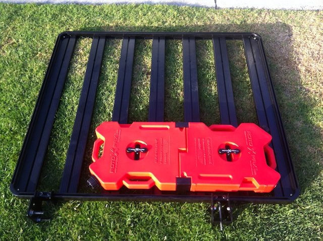

    Added a Frontrunner roof rack this week. Here are a few hints for anybody that is going to tackle this sweet addition to their truck. You guys are only getting iphone pictures for now.
    Buy yourself a 3/4" hole punch. I got mine off Amazon and it was a set for $9.99.
    Line up the holes correctly on the roof drip moulding. You know the old saying of "measure twice, cut once," well lets add to that and "measure 10 times so you only have to cut fucking once or else the fucking holes are off and you get pissed off." Yes, this is a pain the ass if the holes don't line up correctly.
    Assemble your rack and place your stuff where you want them. I have added Frontrunners hi-lift mount and a wolf pack box is on its way. I modified Rotopax's universal mount to put the fuel cans on the roof.
    Mount the rack to the mounting tracks when complete :)

    Looks really good. Are you going to add a fairing to help with wind deflection or are you thinking of putting a LED bar up there?

    40" LED will go up there but I am thinking about putting a lexan wind screen up there.
