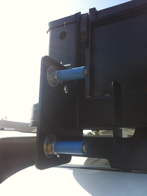

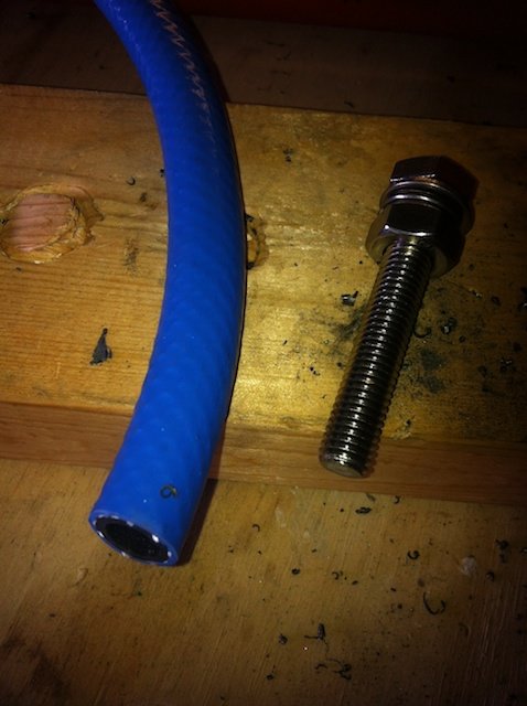

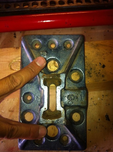

    So there is a fair amount of vibration and noise when using the Frontrunner Hi-Lift mount. You only get one bolt for the hi-lift base plate.
    So what I did was buy 2 stainless steel bolts that are a little thinner. I then got some reinforced tubing that fit snugly over those bolts.
    I cut the tubing to size and enlarged the holes in the hi-lift baseplate and then bolted everything together. My fingers are pointing at the two holes that I had to enlarge.
    Tubing cut to size and placed over the bolts.
    And BAMM, no more noise.
  10. May 30, 2013 at 5:40 PM

    is the tubing there to keep the threads clean?
  11. May 30, 2013 at 5:42 PM
    #991
    MrGrimm
    MrGrimm [OP] Mall Crawler
    Oct 19, 2009
    #24568
    2,848
    Dean
    Wisconsin
    2006 Toyota Tacoma 4WD w/TRD Sport Package
    See build page
    No, the baseplate shakes up and down on the bolts. The tubing minimizes the vibration. It is unbearably loud in the cabin without that there.

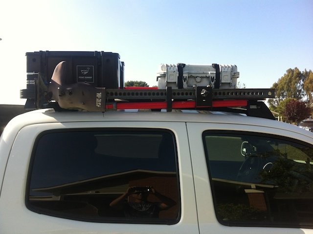

    how did you secure the other Pelican cases to the rack? I just installed a Front Runner rack on my Taco for a RTT, but when it's not on I want to be able to have wheeling stuff like that.

    Some quick release straps tied down to the stainless tie down bolts. I can snap some pictures for you tomorrow.
