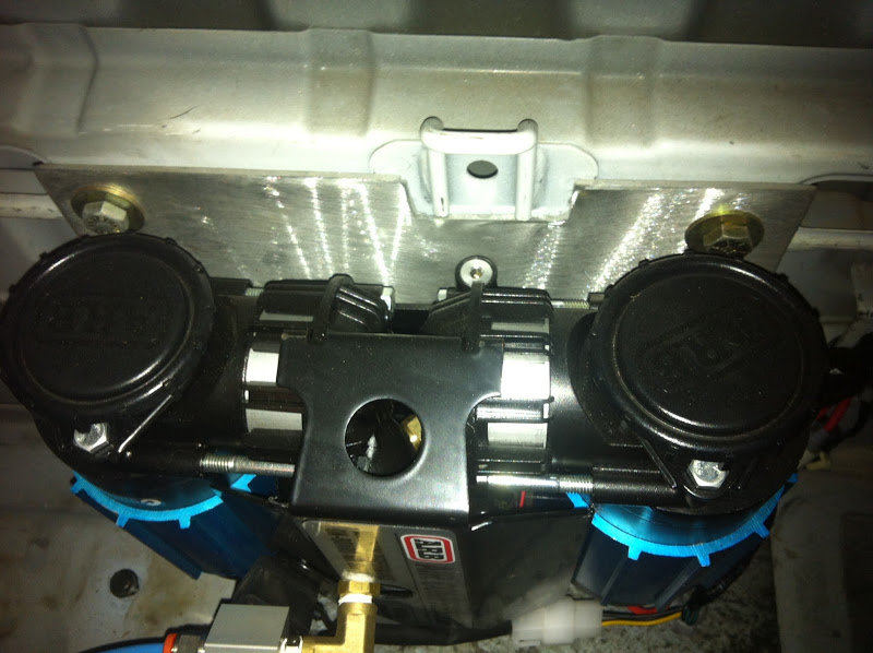

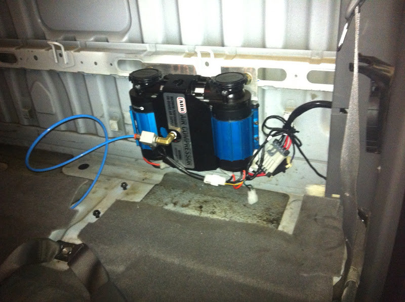

    no tank though just the compressor?

    I wouldn't doubt that it can carry that much weight. I frequently stand on top of it all the time when strapping gear down. Since it is aluminum it doesn't rust that is a big plus in my book.
    Not sure, I will have to look at the alignment sheet in the morning.
    June of next year.
    For now, just the compressor. I plan to add a tank in the future where the spare tire used to be.

    And just the compressor fills up your tires nice and quick?

    All four in under 10 minutes from 10 to 32 psi. With my old MV-50 it was nearly a half hour to fill up 33 inch tires from 15 to 32 psi.

    Did you have a fab shop make that mounting plate? Interested in going this route.

    i held one of those compressors at a shop over the weekend, and holy hell are they heavy lol.

    Not quite set on the twin. May just go with the single and a 2g tank. Should be more than enough for two lockers and airing up 35's (eventually...).

    don't bother with a tank for tires. short of a 30+ gallon tank, there really isn't a benefit when it comes to tires. smaller tanks are great for lower volume or pressure items, where you'd just rather not hear the compresser going, like a small pressurized shower, lockers, horns, etc. a 2 gallon tank at full pressure would get a 35'' up a couple psi before equalizing, and then you're back to square one with the compressor doing all the work. the dual arb, co2, or a belt driven are really the only quick ways to fill up larger tires.
