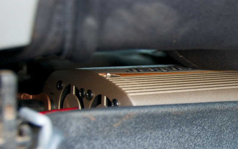

    How did you set up the inverter?

    Dean or me? Not trying to hijack.

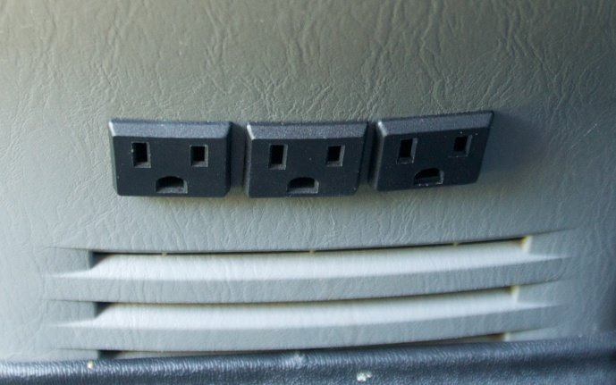

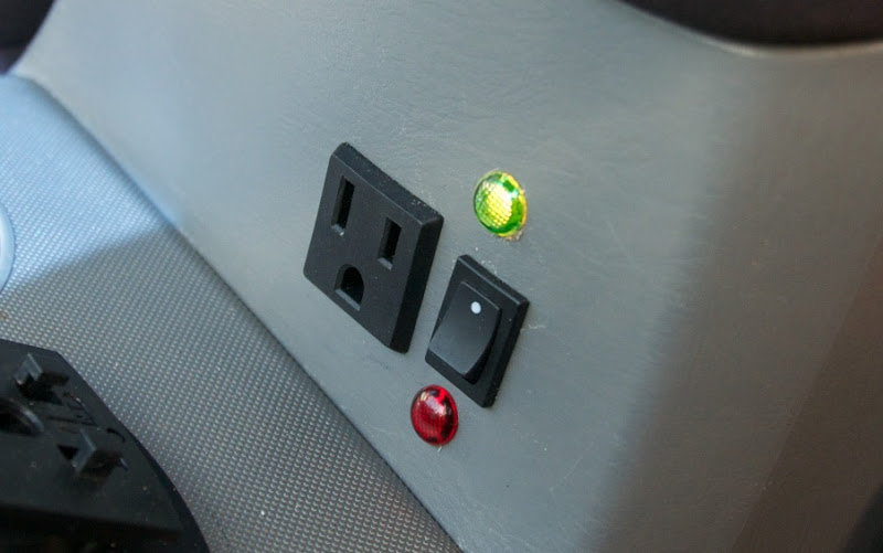

    I bought a Wagan 1000w inverter from Fry's. I removed the panel where the outlets were and then I extended all of the wiring to the outlets. I put the outlets in the center console (3 in the back and one on the front). Mounted the inverter under the drivers seat. Ran 2 gauge wiring with a fuse to the battery. 2 gauge ground grounded to the frame right under the cab. It was a lot simpler than I thought it would be. It's also one of the modifications I use the most.
    Under the seat.
    Three outlets on the rear of the center console. I will say this, if you plan to run three side by side like this, space them out more. One of my sons has a charger for his game, and its wide as fuck.
    Outlet plus on switch on the front. Green is the on indicator, red is the overload.

    Damn, thats clean. Mine is HUGE and will not fit under there. Decided it would go in the Bed mounted under the topper.

    Mr. Dean, how hard was it to do the wiring for the inverter?
    I'm planning on doing something similar sometime soon.

    Wasn't difficult at all. Hardest part was running the 2 gauge wiring. It needed to be ran through the floor under the cab, along the frame and up into the engine bay. Make a really good measurement of what you need because 2 gauge wiring is NOT cheap!
