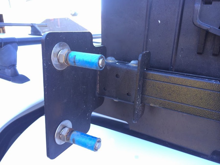

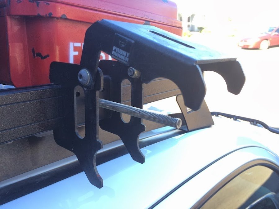

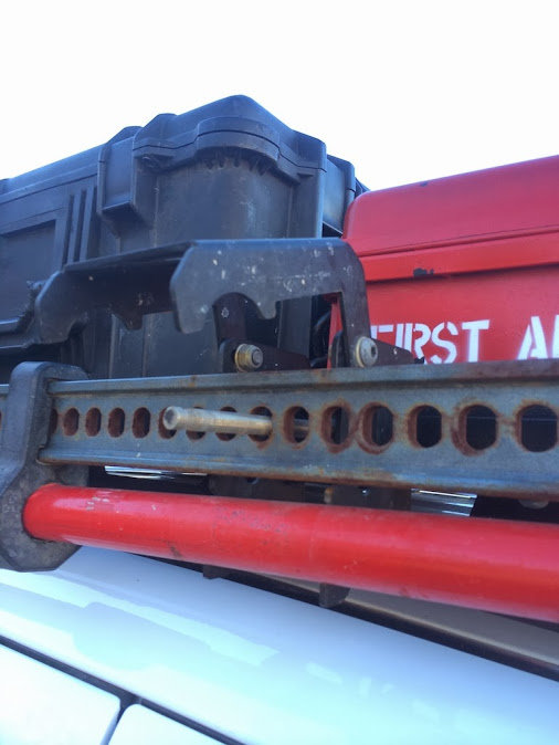

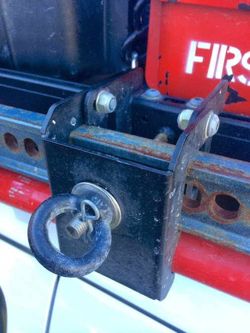

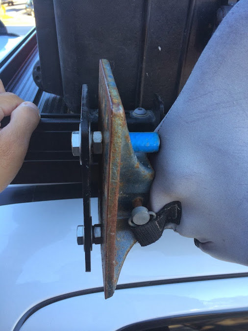

    skygear, pics as requested.
    Front clamp
    After unscrewing the nut, the clamp lifts up and the jack still remains in place.
    Mount open without the jack in place
    Rear mount
    Rear mount without the jack in place

    The pics are great. Last one if you do not mind is straight down the rail from the front of the truck so I can see the 'hook'.
    Like this pic except right down the rail.

    As I looked at it again, it doesn't 'hook' onto the side. It is flat on the top and bottom. It just uses the 3 M8 bolts to secure the front clamp on. The clamp is very secure on there so I don't think a 'hook' is needed in the design.
