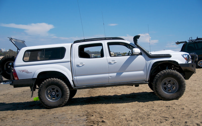

    what cap is that? i remember you saying it somewhere but forget what page.
  6. Dec 28, 2013 at 5:43 PM
    #1466
    MrGrimm
    MrGrimm [OP] Mall Crawler
    Oct 19, 2009
    #24568
    2,848
    Dean
    Wisconsin
    2006 Toyota Tacoma 4WD w/TRD Sport Package
    See build page
    THe current one is a SnugTop Super Sport.
    The one before that was a Softopper.
    The one before that was a SnugTop Rebel (I think).
    The very first one was a SnugTop XV.
    Believe or not, I am on the hunt for a Rebel or XV with the win doors. That will be my final one I promise.

    Hey Dean, I'm on the hunt for a shell for my truck, but it has to be able to carry a roof top tent on the roof plus weight of Poole. Will that one you have work?
  9. Dec 28, 2013 at 9:22 PM
    #1469
    MrGrimm
    Oct 19, 2009
    #24568
    2,848
    Dean
    Wisconsin
    See build page
    Sorry if my typing is all messed up. Got a few adult beverages in me. This Budweiser Black Crown is some good stuff. Look for one that has the Sportman's Package.Any topper that had the roof rack pre-installed had them. For instance, the topper I have now came with the rack. And the first topper I had had them. The Sportmans Package can carry up to 220 KG which is toughly 485 pounds. You can also look for an aluminum top but those are very hard to come by.
