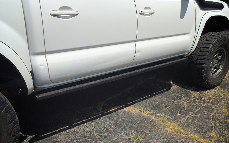

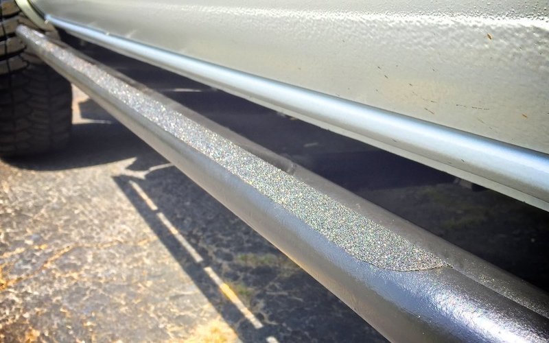

    Just prep the surface with some alcohol. Don't leave any sharp edges and that stuff will stay on there forever. I made cutouts where the legs going from the sliders to the frame was at.

    Wow, thats awesome! Thanks :cheers:

    These came out great Dean. Looks tough as nails.

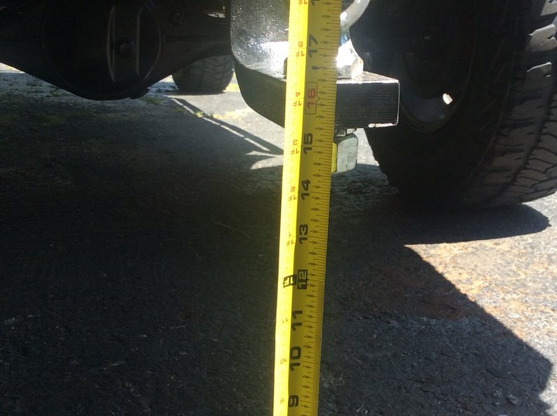

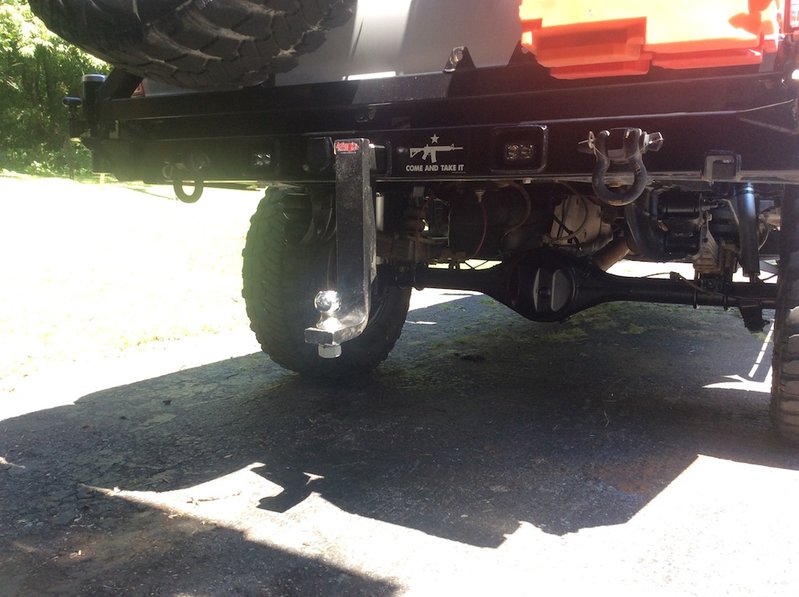

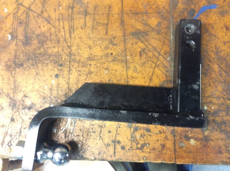

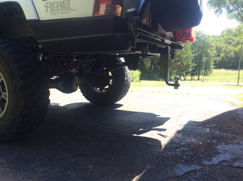

    Some asked about the drop hitch I have on my truck. It is a 14" drop hitch made by Action.

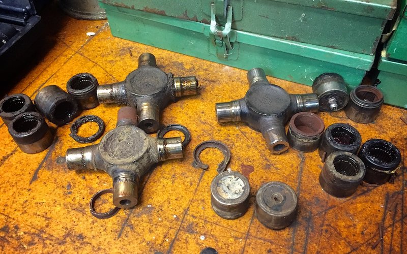

    Well that would explain the noise under my truck, lol

    lol How many miles did you get out of them? I'm guessing those were the original u-joints?

    87,000 miles

    That's a good bit of miles though...

    Yea, considering it was lifted at about 5000 miles so about 82,000 miles at the same driveline angles. I'm good with that.

    What is that?

    what did you end up replacing them with

    U-Joints.

    Thats what I replaced mine with... lol

    I was expecting the Spicers to be more OEM, but after seeing them in person, they are better than OEM. The bearings are longer, the seals are beefier and I like that the grease port is protected. I am going to have to change out the fronts eventually and will be going with Spicers again.
