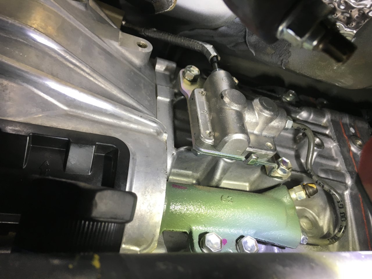

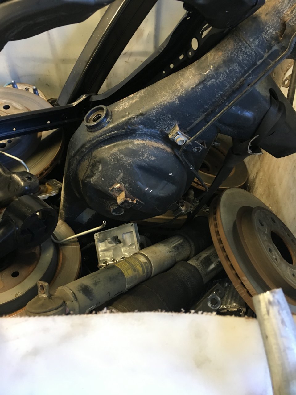

    Finally got caught up at work today and decided to tackle this accumulator BS.
    Originally was going to make a steel braided line for this and after seeing in person how Toyota Plummed it, probably still will.

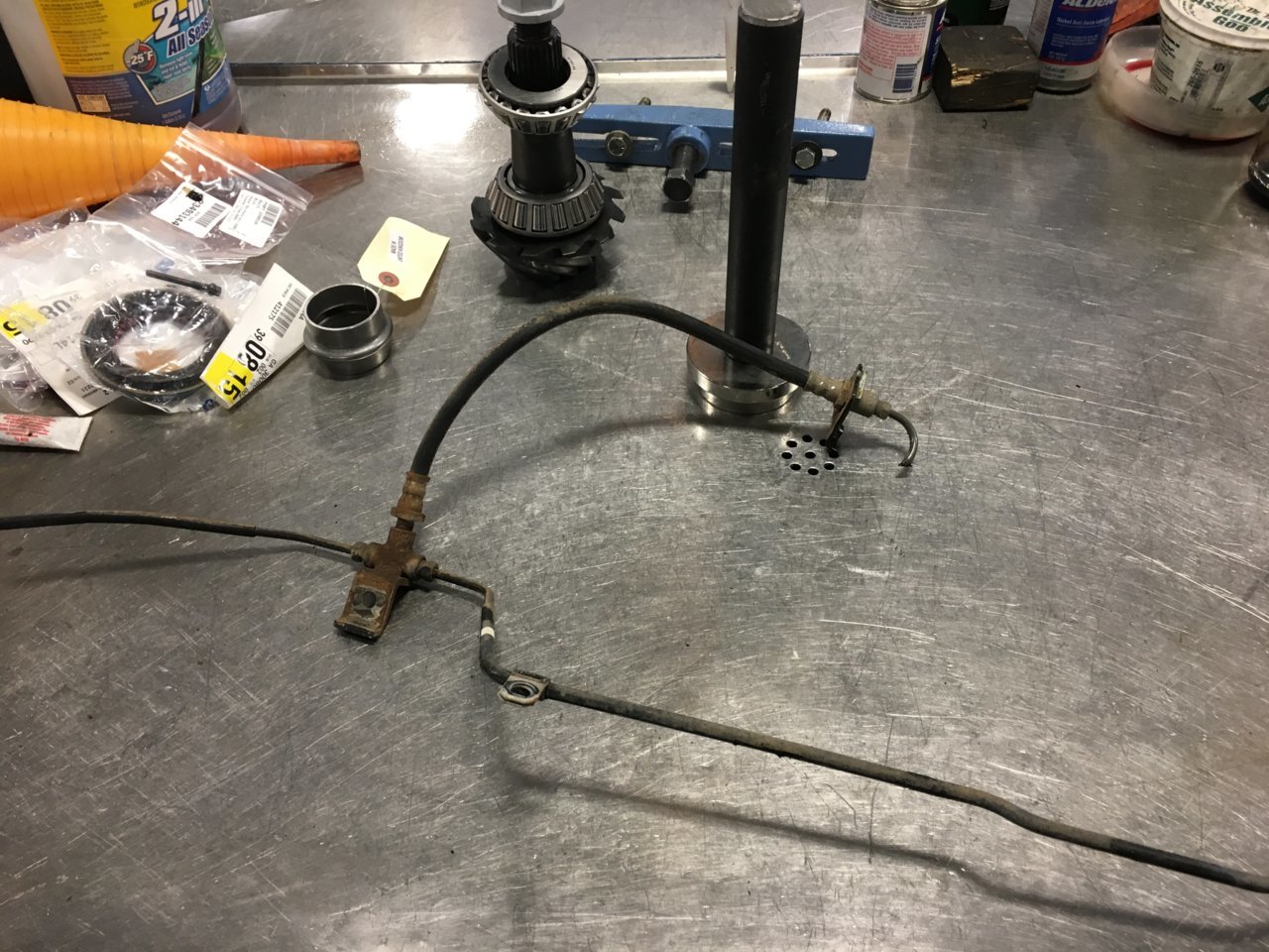

    This was in the scrap bin at work.
    From a 4Runner I put a used rear axle in.
    Free parts! Plenty of brake line with 10X1.0 fittings.
    That is the cause of all my shifting complaints (that silver SOB) :luvya:
    Decided to do this a little differently than @tonered, but only because it was easier for me. Ha!!

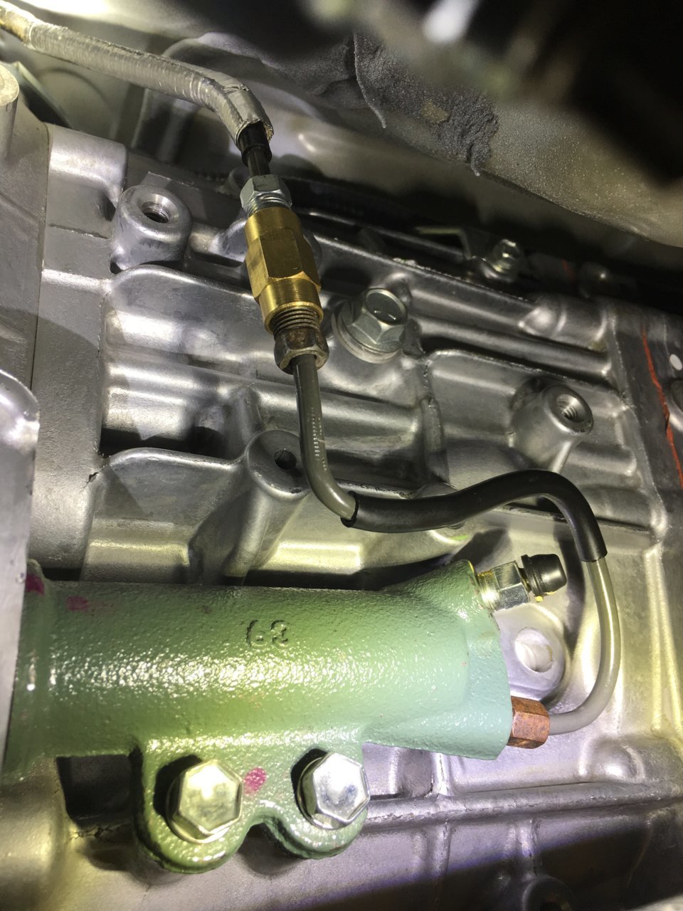

    I made a new line from the clutch slave cylinder (the green thing) to the line coming down from the master (the line into the top of the silver thing).
    Reused one side of the brake line and fitting already with a flair. Formed it up to fit. Formed a inverted flair to the other end and used a 10X1.0 female inverted flair connector to join the line together.
    The bleeder is on the slave cylinder, can be seen in the pic. Gravity bleed was all it needed.
    Done! Success!
    What an improvement! Only 11 miles home, but I’m happy! The clutch engages/disengages in the same point of travel every time. Butter smooth shifts.
    As Tony said the 2-1 downshift is much easier to do smoothly. The thump on the 4-5 upshift is gone.
    As stated I’m thinking about redoing this with braided stainless line, I think it’s a better solution. Need to find the fittings first. Really don’t like the double connection at the top, but that’s just my OCD kicking in. Unless........someone tackles machining a replacement block that bolts right in....
    Say maybe out of brass :thumbsup:
    Won’t mention any names..........but I hear he makes really nice shift knobs!
