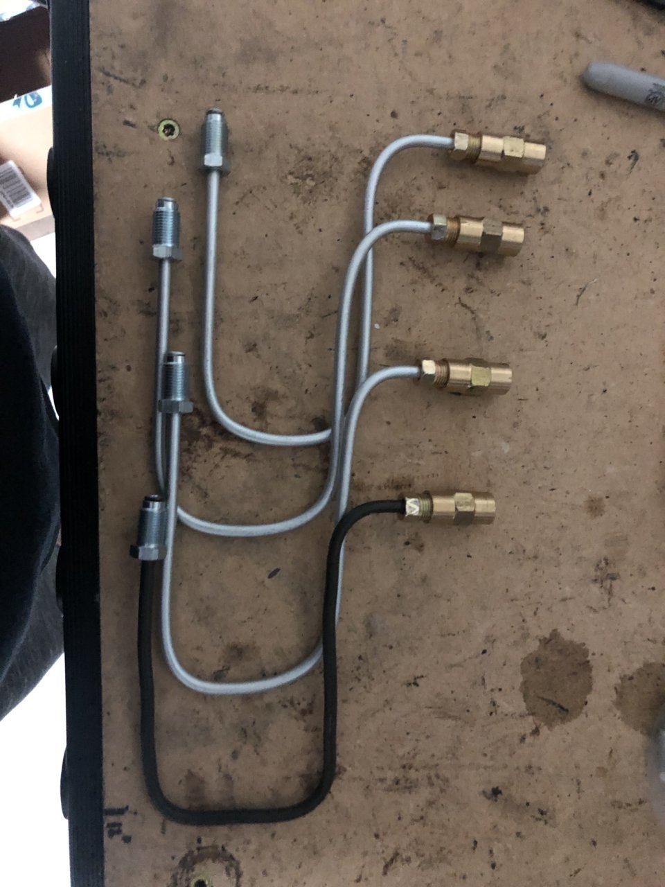

    Okay, apparently there is a batch of trucks that did not come from the factory with a flexible upper line, if you are one of these trucks, you will need to bend your line to look like this:
    These bends can easily be accomplished with using a 19mm deep socket to bend the line around. You just need to straighten the line you have and re-bend. Takes less than 5 minutes to do. You WILL NOT break the line.

    That is interesting as I think there was only a couple configs shown on the parts page? We generally know the 2.7l didn't get the accumulator. I will look again when I get on a screen larger than a phone.
    I know that I have the hard line coming in.

    Front suspension : Extended travel Kings with Total Chaos UCAS Rear suspension : Deaver progressive AAL w/out overload & Kings Rims : SCS SR8 17" Tires : Bfg KO2s 285/70/R17 ARB Compressor ARB Lockers front and rear with 4.88 gears Nitro 4.88 Gears TRD Pro Grill, and fogs Headlight BHLM Rigid Radiance 32 stealth mounted.
    I also have the hard line its covered in an insulator, but definitely not flexible.

    Finished up the tridents bypass kit, and guys.... You were absolutely right, I wish i had done this the day I bought it. Best cheap mod, no more guessing the clutch; just smooth shifts all day long...
    Thanks @tonered for spreading the word and @Trident904 for making the kit. :hattip::thumbsup:

    I have stuff coming in this week to make 20 more. Will fit 2nd and 3rd gens.

    18 kits built, bent, and ready to ship.
    I will be out of state next week, so if anyone wants one, order before this coming Sunday so I can ship on Monday before I leave town.
