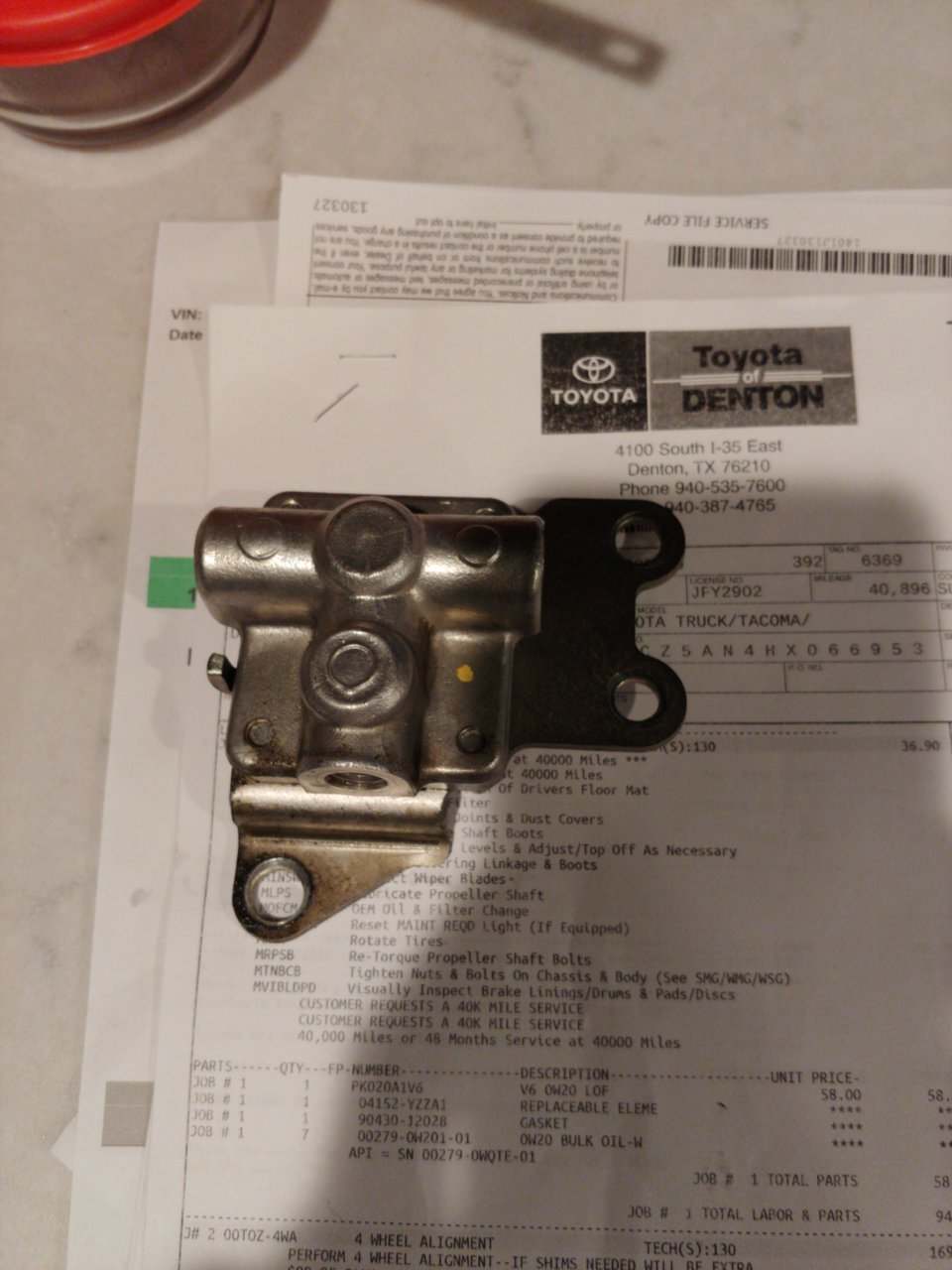

    OK who wants it? lol
    so here's my feedback on the ADM...
    - i did a hard line bypass rather than a flex line.
    - my experience isn't as big a change as most everyone reporting on here. that's probably because i have had the return spring removed all year, so the ADM after no return spring is not as big a change, although a clear one. qualitatively it's similar in weight and all, just a bit more definition as it bites & releases. i can engage and feel the chatter for the first time since buying the truck over 2 years ago.
    - this has basically tempted me to want a Stage 3 URD clutch, but i'm not spending cash on that if my stuff still works. maybe one day, maybe turbo with it?
    - one interesting thing just to report: Pablo was curious after bypassing it, so he initially left the return spring off and assessed it w/o the spring after completing the ADM. he said the spring is absolutely necessary if no accumulator. basically the return spring pulls the clutch back out of engagement. if it's not there, the clutch kind of sucks in from the negative pressure, making it almost impossible to feel & modulate. he said, aside from being nearly impossible to drive, it didn't feel like a clutch. so the return spring is back on. and it feels like a totally normal setup now, just a little light for me.
    - the bite point moved down a bit to around mid-travel, before it was close to the top.
    - all in all it's much better and more comfortable as well. but i'm now hungry for much more, but stopping here for now.

    It still makes me laugh at myself that you feel the clutch isn't much heavier without the spring. I'm a mess. :D
    I wonder about heating the spring to soften it a bit, or rebend it to get less preload? Maybe a shop might know how to alter it without destroying it?
    I agree the spring is a bit too strong and its motion is not linear. It is unfortunate that we cannot do the linear spring mod that the 2nd Gens can.
    One option comes to mind that I do not know if it would work. Swap in a 2nd Gen pedal, but keep the 3rd Gen master cylinder since it is metallic not plastic?
    su.b.rat[QUOTED] likes this.
