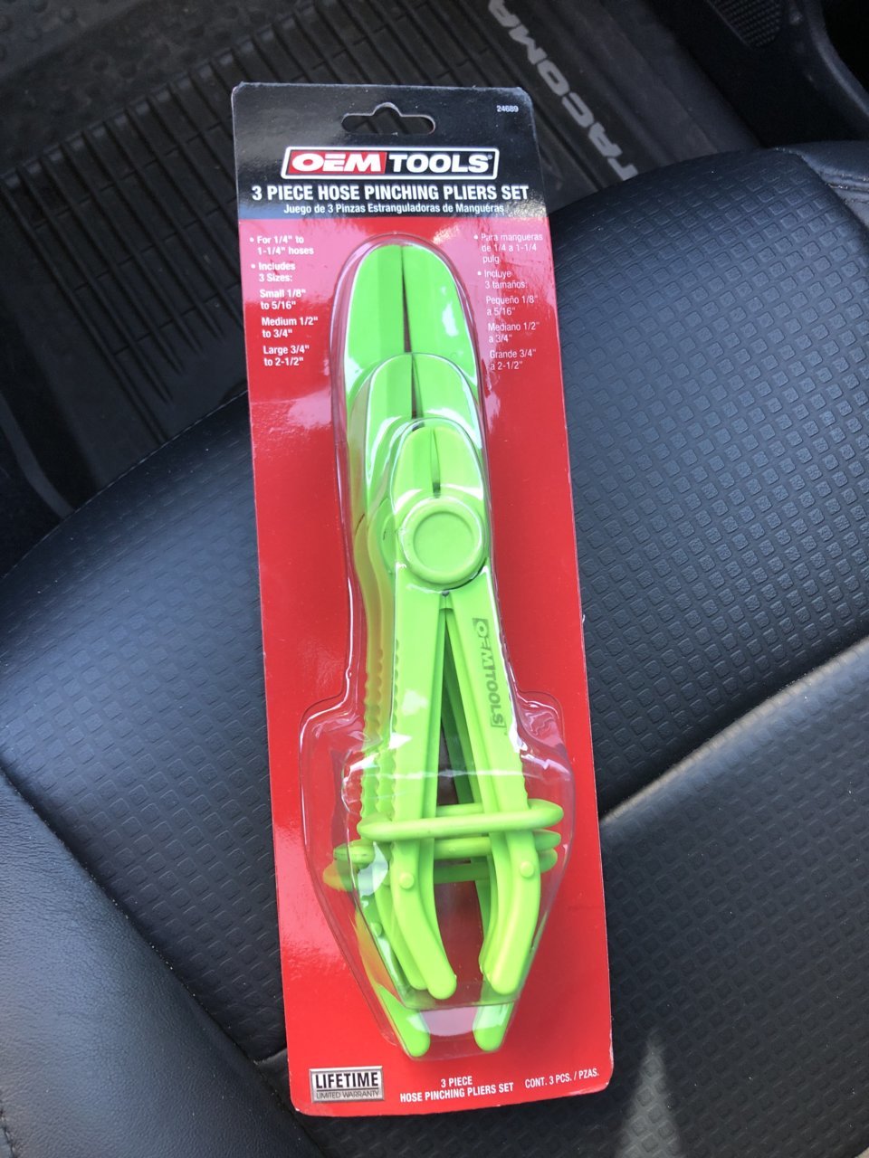

    Ya this is nuts, I keep having to refill (slightly below minimum line) just from loosening the one that connects to the slave. Going to have to figure something else out.

    Auto parts store, ask for a line clamp. $3. Works like a charm. Soft plastic "blades" so they pinch well without damaging the line.

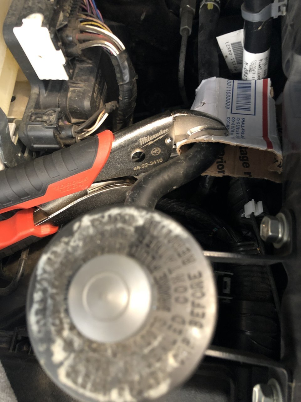

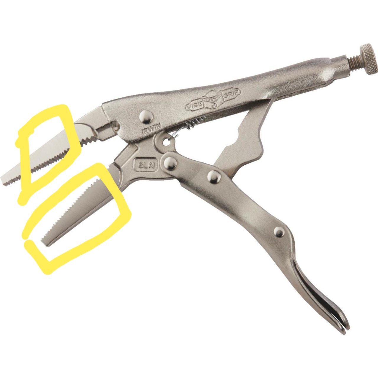

    I have a couple of dedicated hose clamps, but have used this idea many times.
    Add two pieces of fuel line or vacuum hose, over the long thin jaws of a needle-nose vise grips. Plenty of locking pressure, but less likely to damage the outside of the hose you're clamping.

    I am sorry to say, but you're not clamping off anything there. The tips of the jaws need to be centered on the hose.

    This is what they sold me

    Those should work.

    Same set I've got.
