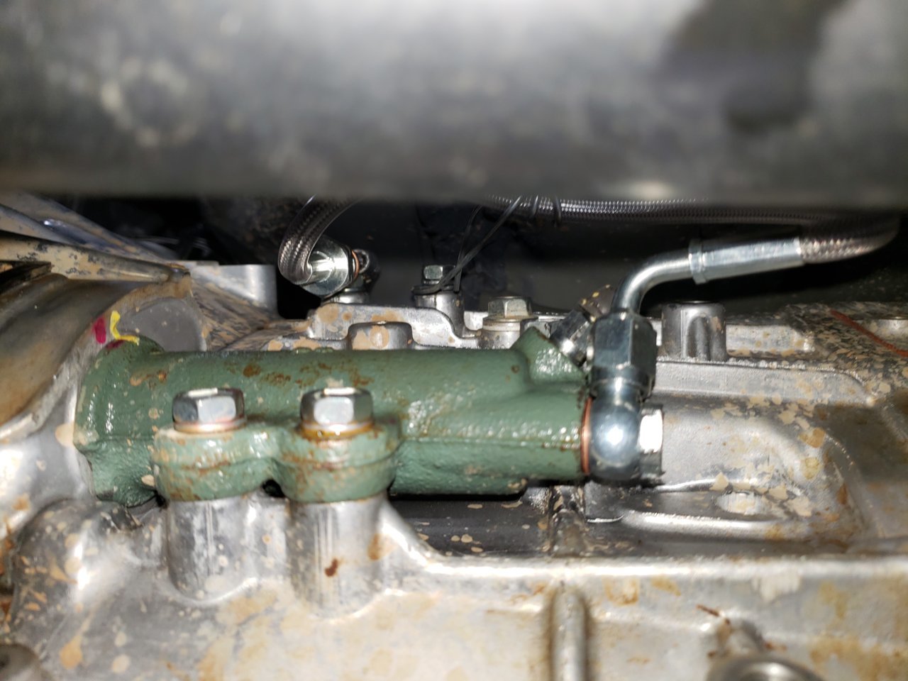

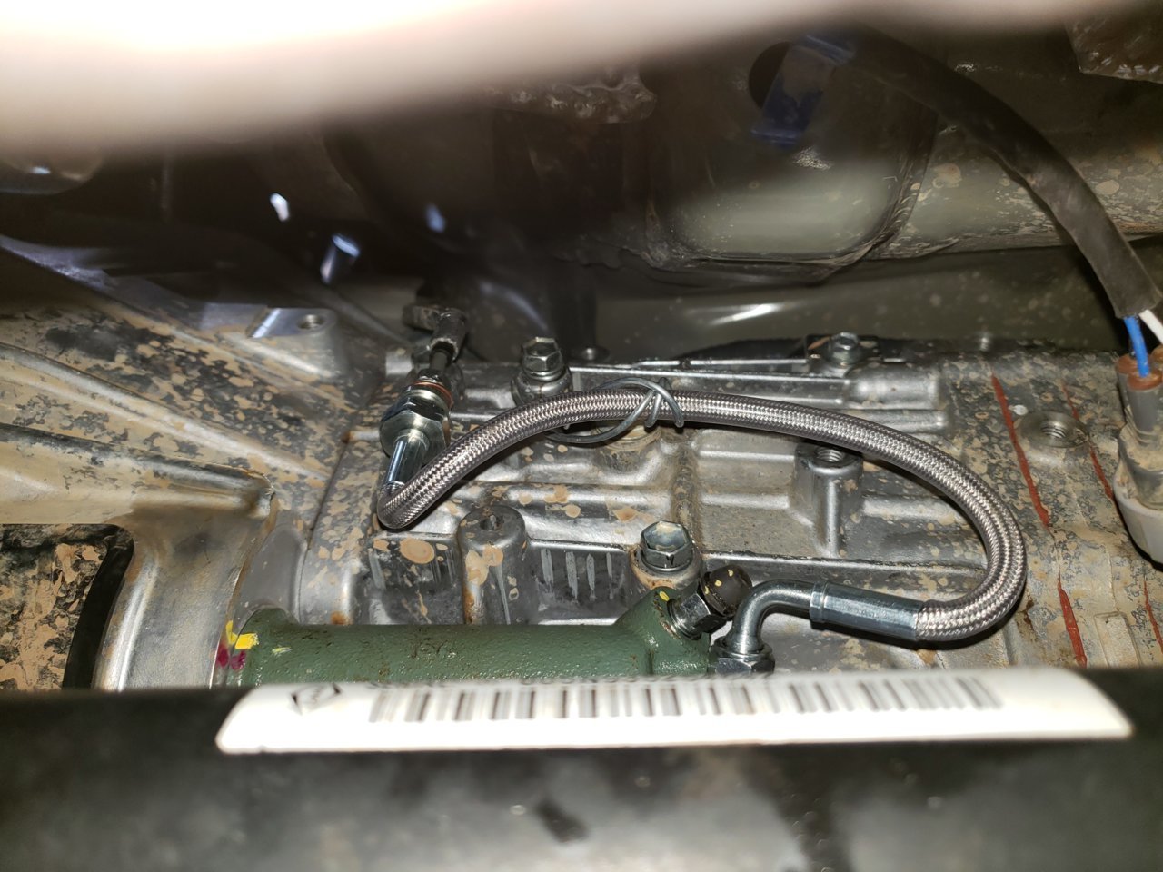

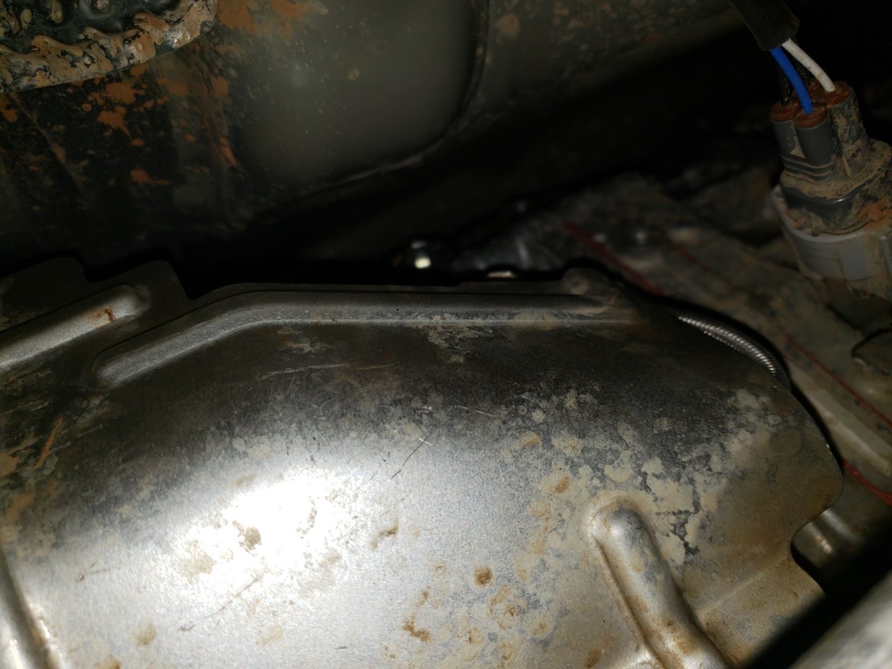

  18. Mar 5, 2020 at 2:16 PM
    #1538
    C41n
    C41n KDMax Pro Authorized Tuner | Portland, OR
    Jul 24, 2019
    #300113
    1,237
    Anthony
    Portland, OR
    2020 DCSB OR MT
    Bled the clutch today. I think the reason I got air in it was the tube I was using was not fitting snugly on the bleed nipple. Got some smaller tubing that fit correctly followed @shellshock bleeding directions. Thanks for those @Shellshock.
    I got a lot of air out. Afterwards the clutch not acts normally.
    I haven't driven it that much yet, but I LOVE it! :D:D:D:D
    This is how the truck should have come from the factory. WTF toyota? o_O
    If you are on the fence about this mod, and at all unhappy with your clutch, DO IT!

  20. Mar 5, 2020 at 6:17 PM
    #1540
    GF8er
    GF8er Well-Known Member
    Oct 23, 2017
    #233920
    638
    MT. Hood
    18 MGM DCSB TRD OR 6MT
    You should have a copper washer on both side of that banjo fitting.
