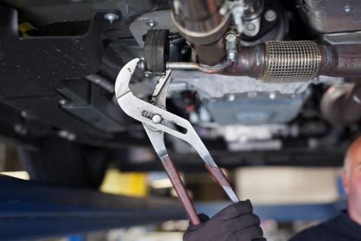

    silicone spray lubricant and channel locks has always worked for me

    Okay, make sure you lift your truck by the frame, that way your axle can drop down for more space. Then you have to twist and rotate the stupid thing. Or just cut the pipe.
    Exhaust hangers are easy. Lubricate the hanger and hook. I use silicone spray, but a penetrant will work as well. The use channel locks to push the knob of the hook through the hanger.

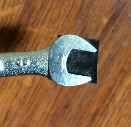

    I have pretty good arsenal of tools including a brake line bender and double-flaring tool. I used my needle-nose vise-grips with the jaws protected with 3/8" pushloc hose to pinch the hose going into the master cyl. When I disconnected the lines, I didn't get maybe 4 drops brake fluid total and nothing out of the slave cyl (don't crack the bleed port!). I used comb wrenches as suggested and didn't have to take the D/L or exh support bracket off. I bought the same parts illustrated on pg 56 of this thread plus a 1/2" adel clamp around the brass union body (also illustrated somewhere in this thread). I removed the modulator off it's bracket and then re-installed the bracket. This made perfect alignment to use one of the empty 4 holes to fasten the adel clamp. You can use one of the 4 left-over modulator bolts and a 6mm nut. Hint - use a small piece of electrical tape on your open-end wrench to hold the nut in place while turning the bolt (it's tight up in there!).
    Before I attached the tube to the slave, I placed a rag on the ground and cracked the vice grips for just 10 seconds and a peek underneath confirmed fluid dripping out. This charged the length of replacement line. Connect the tube to the slave, removed the vise grips, and have the wife pump the clutch 10 times to check for leaks. Then buttoned on the shield.
