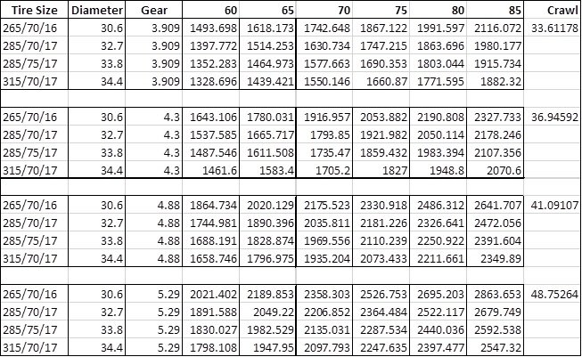

    Since the MT pushes a higher rpm with stock 4.3 gear ratio than the AT does with 4.88’s (do to the double overdrive in the AT)...based on the math and drive-ability with tires under 35”...depending on tire width/weight of course) 4.88’s with the MT sounds pretty darn ideal.
    I run 4.88’s with 32’s in the AT. I can only imagine how awesome the MT would feel without the double overdrive even up to 34” tires
    I vote 4.88’s with the MT as long as 34” tires or less
    Even though these are AT numbers, it may help to extrapolate these knowing your MT will push higher RPMS. I hope this helps you out in some way

    Wow. Good to know, but the MT still pushes higher rpms than the AT. Even Nitro gear mentions in their YouTube videos that the MT pushes high rpms in stock gears compared to the AT with 4.88’s. I still think the 4.88’s are ideal. Nonetheless thank you for this because I was not aware the MT had double overdrive

    Thanks. This is very handy: http://www.grimmjeeper.com/gears.html
