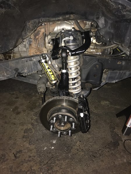

    Anyone running limit straps to prevent the uca from hitting the coils at full droop??

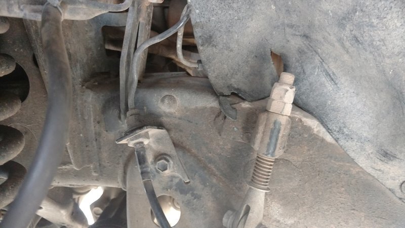

    Hey y'all so I think I've got my rear suspension figured out. So for sure going with the dakars for leaf pack, all pro u bolt flip with wheelers super bumps @ARCHIVE shackle flip and the ext travel b110's and last but not least ext brake lines. Anyone running this setup or something similar? Also I believe @Downsouth Motorsports does a 10% discount for TW members right?

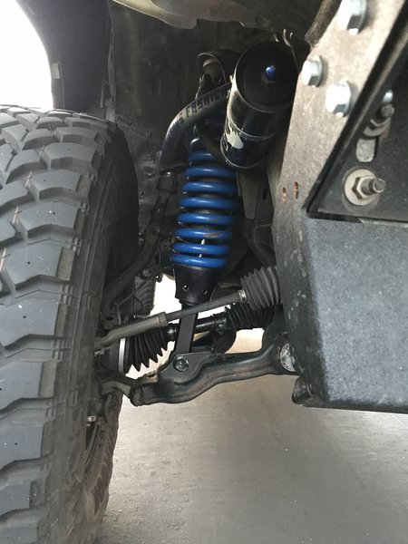

    What length strap
    This was before I lowered the adjuster...I have lowered it pretty much all the way to the top now
    You can see in this photo that the uniball cup rapes the coil pretty bad. The way I have it now it only hits on the drivers side...not sure why

    You can't adjust your spindle height to avoid contact with the coilover??

    Where are you planning on mounting the bottom of the strap, the shock bolt?

    I've seen people either do that or weld a tab at the rear of he lca

    6". Shortest you can get. And use an adjustable cleavis. Used almost all the adjustment on mine, should have put the.miunt higher.
    Id use the shock bolt if you have stock LCAs.

    Sweet thanks...I wil probably go with a 6" and adjustable Clevis....can't believe the price of the clevis

    Is your 6" strap hooked the the shock bolt?

    No, mine is hooked to the dedicated tab on my @Dirt King Fab LCA :)

    I think I'm gonna go with 8" kartek straps on the shock bolt
