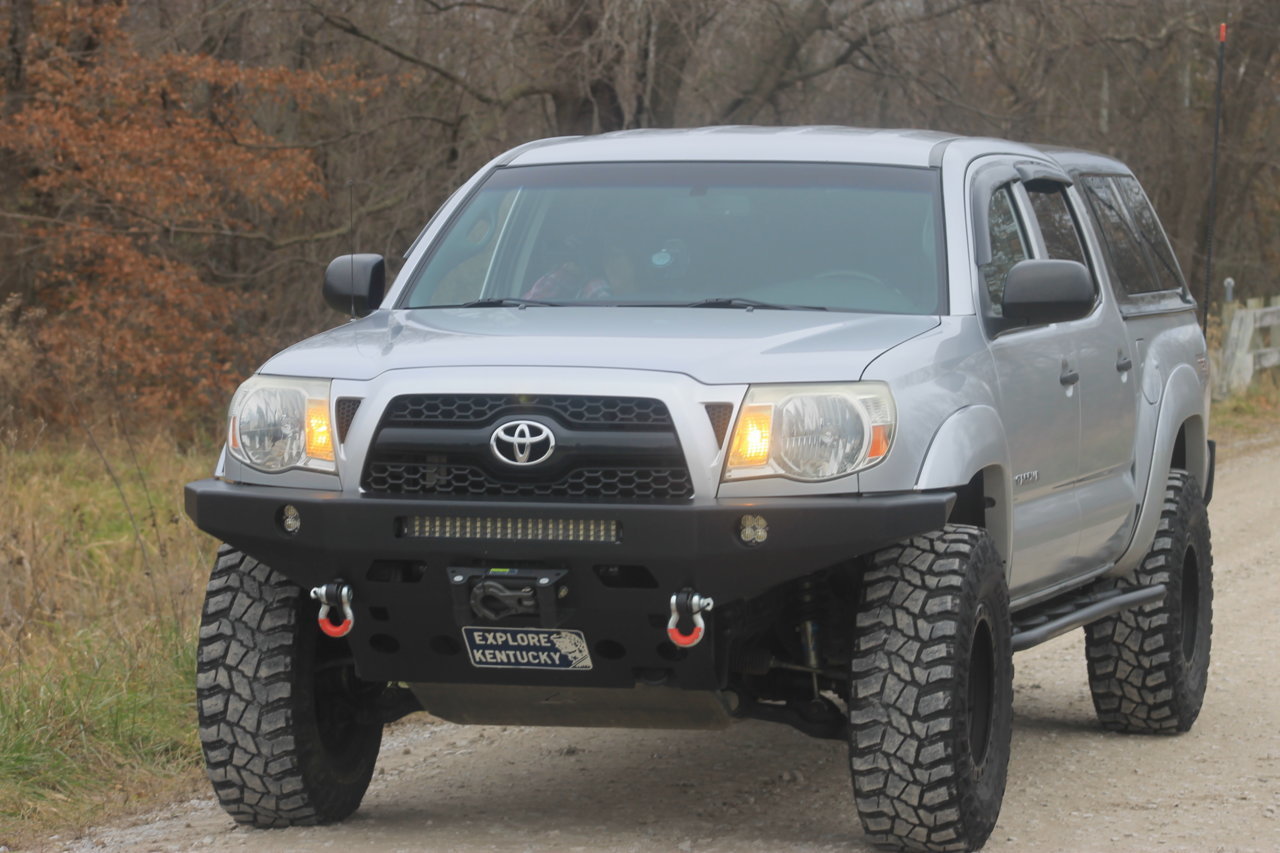

    2011 DCSB, TRD OR, 5100's, 885's 285/75r16 Cooper STT PROs.
    I've had several brands, including BFGKM2's (on a Dodge truck I owned) At the present time, I'm 110% sold on Cooper STT PRO's. I'm running 285/75r16's now, but would not be opposed to 265/75r16's. Just not THAT much difference in size to effect off road capabilities in a serious way. STT PRO's wear good, balance well, ride great for a mud tire, reasonably quiet for a mud tire, and do incredible in the mud....Good street manners.
    I'm on my second set. There will be a 3rd set some day.
    There's 10 times as much rock here as there is mud. STT PRO's work equally well in rock as they do in mud. Not one cut or chunked tread so far. Best all around performer I've found to this point.
