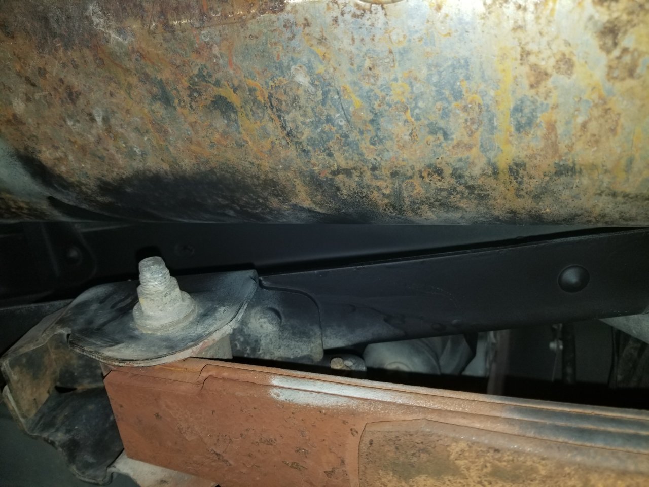

    Here is a picture about the small gap between the muffler and frame.20190217_172346.jpg

    doubt that's causing the frame to rust any faster, by the time the exhaust gasses get to the muffler there is not too much heat that would be causing the paint or powder coat to bubble up. what I'd do is take a thermography camera or IR gun and shoot it to confirm your suspicion first before spending money on the heat shield. To answer your question where the heat would go, the muffler would be hotter inside so the exhaust gasses would exit the tailpipe at a higher temperature.
