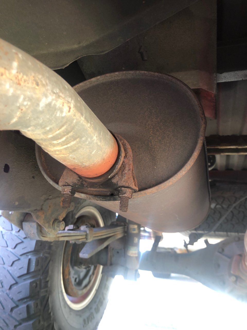

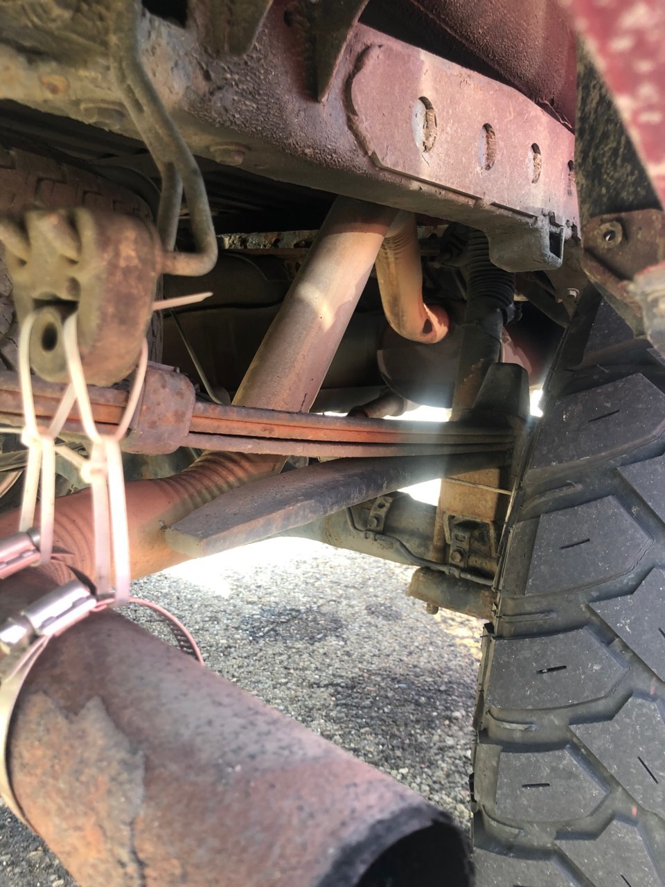

    Okay, here's an update:
    Pic of inlet side:
    Outlet side:
    And of the tailpipe:
    The dimensions are 20" x 7.5" x 9.25" and it looks like its offset/offset. The dimensions on the Borla are 19" x 4" x 9.5". Here's a video of the 40664 muffler on a 4runner: https://www.youtube.com/watch?v=iI39tF-0bvU. I really like the sound of that muffler and if he got it to fit it's obviously possible. I think I'm going with the center in offset out because that's the only muffler they make that's 19" long. I know I'm just throwing words out at this point, I tend to overthink things a lot :D.

    It likely doesn't really matter, especially if you're getting all new piping too. Sounds like your hangers are rusty, so you're likely to end up cutting them off entirely and welding new ones on. When you do that, you can install the new hangers pretty much anywhere you need.
    If you're having a muffler shop do the work, they'll be able to take care of that no problem.

    Honestly, don't go by the sounds from a video. I've seen many people get bummed out when they realize the sound isn't quite what they thought based on a video. It always sounds different in real life.
    But yeah, if you're doing a whole new exhaust, you'll be able to get it up in there in pretty much any orientation you want.
    Nice zip ties, btw...

    Haha thanks. As much as I like the look, I think I should probably find a more permanent solution. I'm also going with the Borla since they seem to be high quality and from what people have discussed they don't make the truck sound like a rice cannon. I also don't want to have my muffler rust out every couple years dealing with the salt and chemicals from winter. Thanks for the replies!
