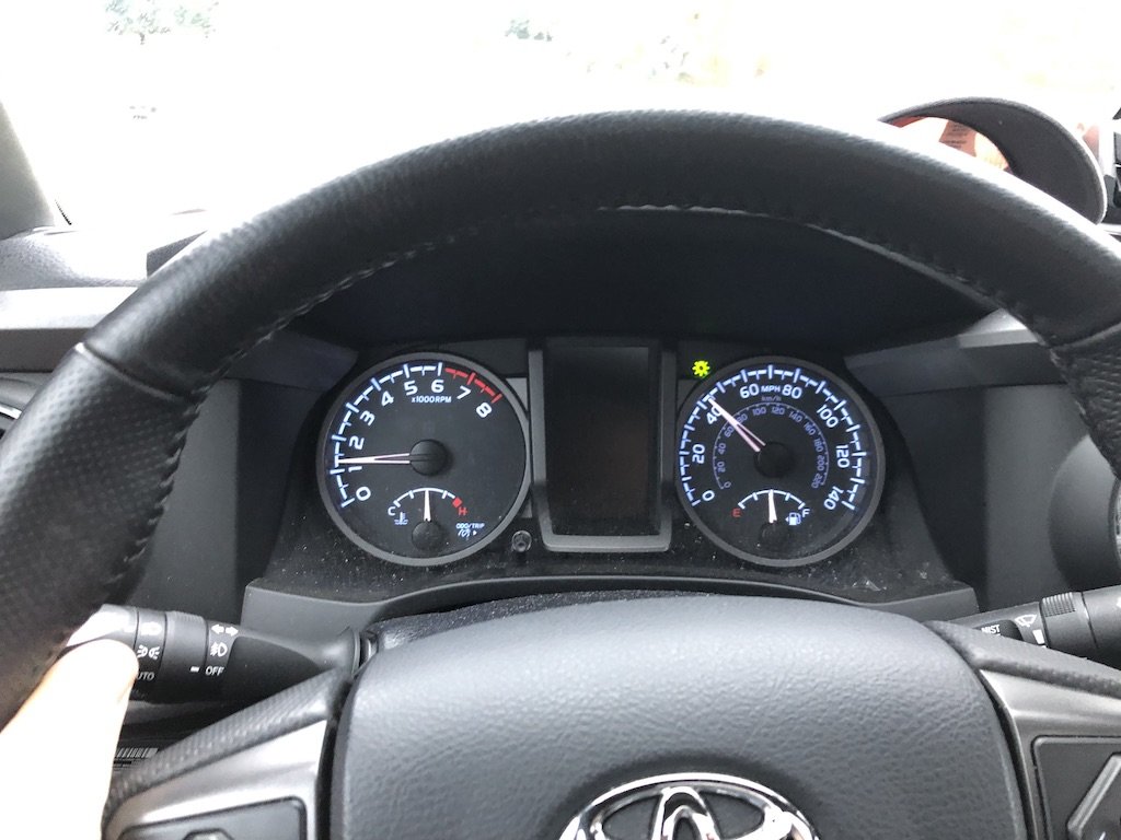

    Driving to work this morning I noticed the multi-information display was black/off. I tried using pushing a few steering wheel buttons to no avail. I pulled over and restarted the pickup and the multi-information display remained off. After about 10 minutes driving, the display randomly turned back on and acted like nothing happened.
    Anyone experience this?

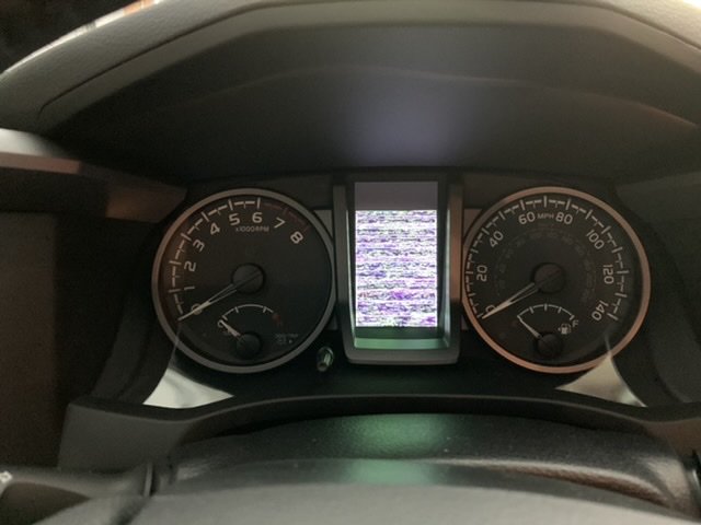

    Sorry to revive this again, did you get yours fixed? Did they just replace the unit or did you get any indication of what the root cause was? I had this issue this morning on my new 2020 :(
    It didn't go away with just a restart but it did go away after i ran an errand and then came back after it sat for a few minutes. Hasn't happened running other errands today, wondering if there is a bad ground or bad connection somewhere.

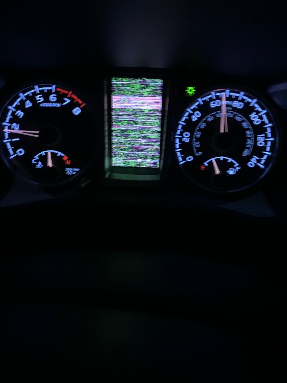

    Glad I found this thread. I just left the gym and I see this screen. My 2020 SR5 has less than 4,000 miles. Just got home and powered down. Hoping this will fix itself after I eat dinner.

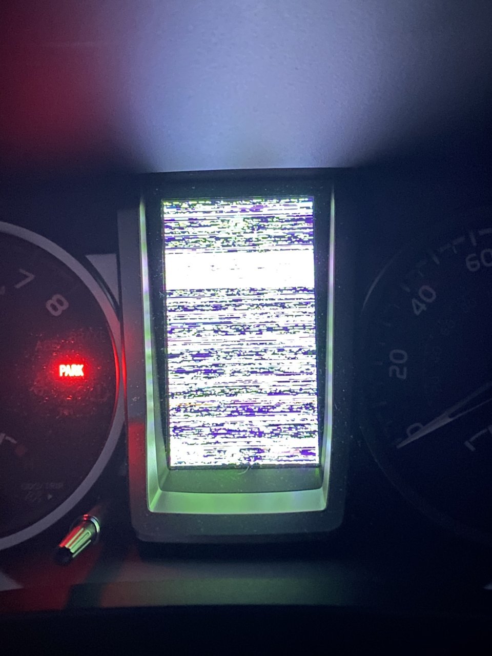

  20. Jul 17, 2021 at 1:24 PM
    #20
    rsimi72
    rsimi72 Well-Known Member
    Mar 31, 2017
    #214965
    590
    PNW
    2020 Tacoma SR5 Access Cab
    Just got the center display fuzz like your pic. Left it for 30 min. and restarted and all was back to normal. Hoping it’s a one time thing. Has yours continued to work correctly?
