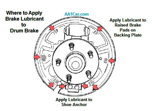

    Did you grease between the backing plate and the brake shoes it sqeak if you dont

    I had a Prerunner that used to do that. I replaced the rear brakes and it went away. I Greased everything while I was back there. May just need grease

    I had a squeak at my rear brakes when releasing the pedal. I pulled the drums off and sprayed everything except the shoes down with brake cleaner. Now my squeak is gone.

    Grease points on drum brakes this is a generic picture bit you get the idea you can see where the shoes make contanct with the backing plate these points need to be greased
