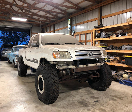

    Its still a work in progress, but i have a build thread here: https://www.tundras.com/threads/the-cream-pie-a-2005-4wd-ls-5-speed-sas-conversion.50841/

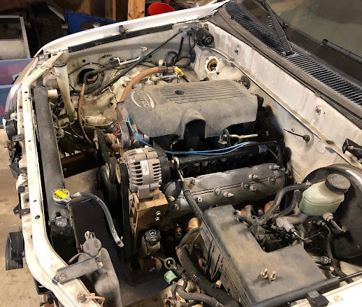

    Updated engine bay pic with some minor changes.
