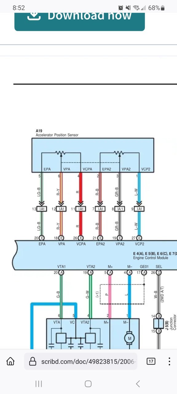

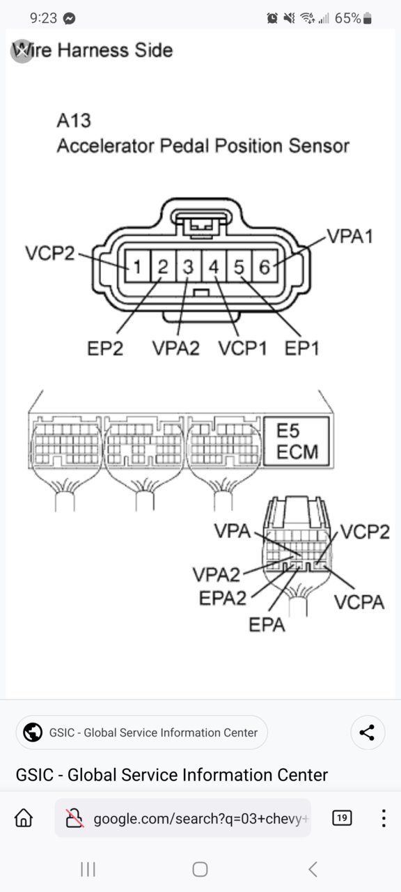

    well you asked for specs..... 06 trd sport speedway blue 5.3l v8 4.0 camburg lift spindles extended travel icons total chaos lowers allpro 4" leaf pack 17" xd hoss rims 37/12.5/17 mickey thompson baja atz Allpro hybrid bumper grill craft grill wicked flow muffler inside i have..... wet okole real tree camo seat cover blue oznium dome light stealth sub box with 2 10" kicker comp subs kicker 400 watt amp weathertech floor mats
    Hey munkey was curious if you looked into using the factory toyota gas pedal or not I was looking up some things and it looks like if you get the toyota connecter and remind it you could follow to the Gmail wiring properly. The only thing I don't see is what the resistance is supposed to be.
    munkeywrench[OP] likes this.
  18. Jun 5, 2023 at 6:07 AM
    #118
    johnw

    06 prerunner v-6 4.0L 4 door
    Toyota wiring

  20. Jun 5, 2023 at 8:03 AM
    #120
    munkeywrench
    munkeywrench [OP] Well-Known Member
    Dec 11, 2018
    #275524
    83
    LS Swap
    Yes I did look into this after I had it running. I think it may work by changing the wiring around I just never got around to it. I am pretty sure you can change the pedal resistance on HP tuners to make it work.
