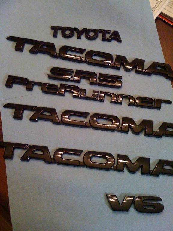

    6" Pro Comp, rockstars, nittos, black mods on interior, debadged, color matched chrome bumper and grille, dynamat inside doors and floor MORE TO COME
    1. Took off the badges using fishing line, and a hair dryer.
    2. Washed them in car wash and rinsed.
    3. 3 light coats of Adhesion Promoter.
    4. 5 light coats of Krylon Fusion for Plastic, gloss black.
    5. After 7 or so minutes of last coat apply first coat of Clear Coat.
    6. 3 additional coats of Clear 5 min apart. let sit in sun to dry.
    7. This step is optional, i waited about 36 hours and hit it with 2 more coats of Clear.
    Check out the results....

    Great job! I like what you did with the engine cover too!
