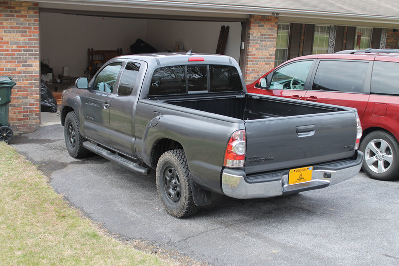

    Now that the truck is lifted and has the bigger tires, I like it. It is definitely a major upgrade from the stock “passenger car” stance. I will note that the ride is much different than anticipated. It seems like I feel every bump in the road now with the AAL installed as the suspension is a lot stiffer. One of the chief benefits of getting the longer AALs is a smoother ride from what I gathered, so I can’t imagine how stiff the short AALs could have been. I’ve put about 2000 miles on the new suspension now and it seems a little looser, but perhaps that could be attributed to having gotten used to the new ride.
    PAINTED WHEELS, BLACK BOX MOD, 30x9.5xR15 KO2s, 2.75" Spacer Front & 1.5" Longer AAL Rear LIFT (DRIVER SIDE):
    PAINTED WHEELS, BLACK BOX MOD, 30x9.5xR15 KO2s, 2.75" Spacer Front & 1.5" Longer AAL Rear LIFT (FRONT DRIVER SIDE):
    PAINTED WHEELS, BLACK BOX MOD, 30x9.5xR15 KO2s, 2.75" Spacer Front & 1.5" Longer AAL Rear LIFT (REAR DRIVER SIDE):
    PAINTED WHEELS, BLACK BOX MOD, 30x9.5xR15 KO2s, 2.75" Spacer Front & 1.5" Longer AAL Rear LIFT (REAR PASSENGER SIDE):
    As far as the appearance, while I do like it, I think I would have liked it better with 31s. However, from a performance perspective, I think 30s are a good compromise. For daily driving in a pretty flat area, it’s still got a little power. In the mountains, I recently found its power limitations are more apparent.
