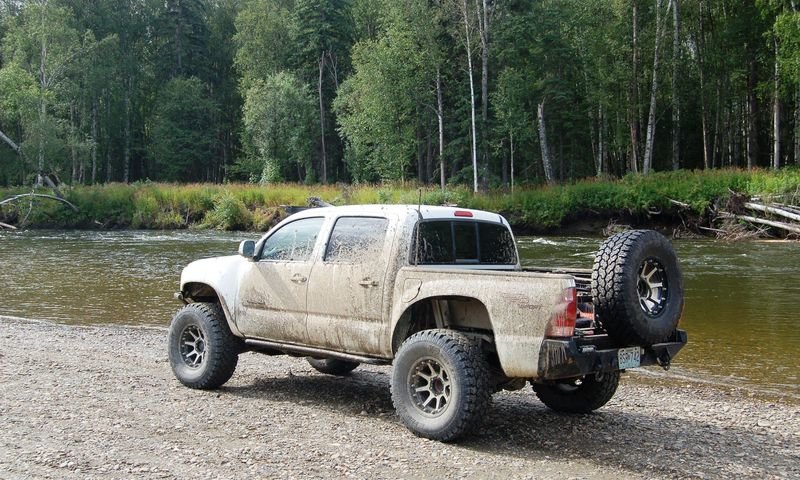

    My truck is a 2006 TRD Sport 4x4. It's been a continual build over the past four years and is nearing "completion".
    Hopefully I will have some good weather this weekend and be able to clean the truck up and take pictures to capture all the changes. Here are some recent photos; wheeling pictures are buried throughout this thread.
    Drive Train

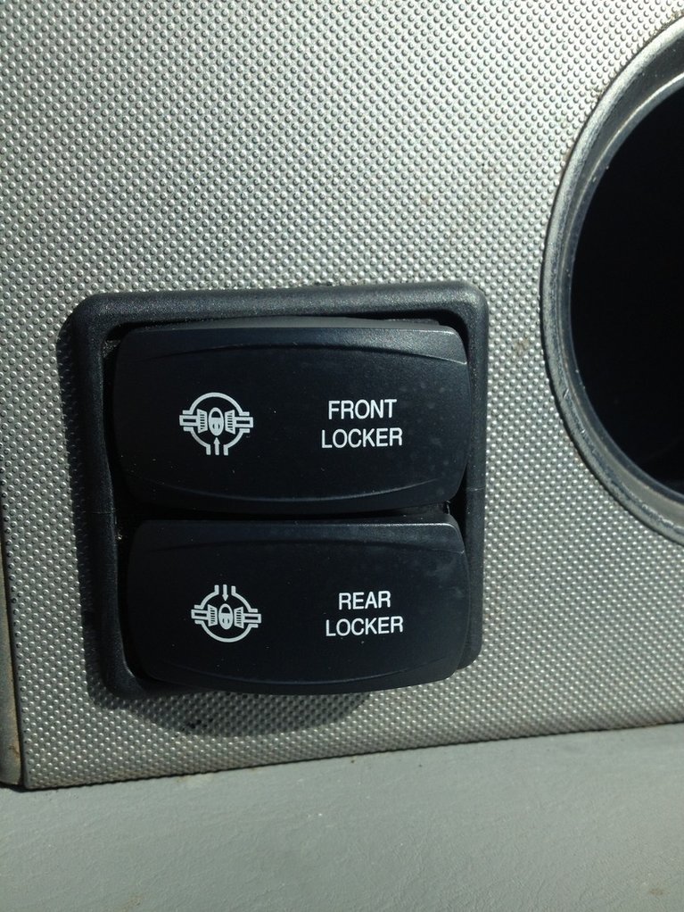

    ARB Air Lockers front and rear
    4.88 Gears
    Front Suspension
    All Pro Long Travel
    Fox 2.5 Remote Reservoir Coil Overs
    Rear Suspension
    Defined SUA Long Travel
    Bed Cage (home built)
    Fox 2.5 16'' double bypass shocks
    Bracing and Gussets
    Total Chaos UCA Gussets
    Total Chaos LCA Tabs
    DMZ Engine Mount gussets
    All Pro Spindle Gussets
    Wheels and Tires
    35'' Pro Comp Extreme A/T's
    17'' XD Addicts
    Lighting and Electrical
    Blue sea fuse box and breaker

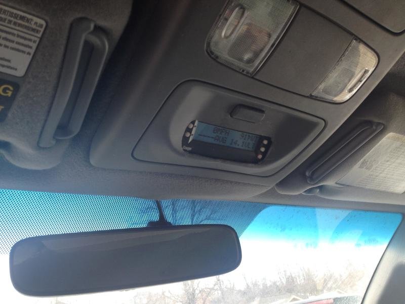

    ScanGauge II mounted in overhead console
    20'' and 50'' LED light bars (forward), 6'' single row LED (rear)
    Flush mount trailer wire receptacle plug in in rear bumper
    Navigation
    Hard mounted Garmin 60csx (RAM mount)
    "Techdeck" by Birddawg Industries to mount a full size iPad with GPS.
    Communication
    Cobra 75 CB Radio
    Kenwood 281 2 meter ham radio.
    DeLorme InReach satellite messenger
    Recovery and Safety
    Warn 8,000 pound winch (rear mounted)
    Hi lift, shovel, ax, and hi lift base mounted in bed
    Fire extinguisher mounted in bed
    CLS bag and survival bag
    Exterior
    All Pro fiberglass front fenders
    Trimmed bedsides

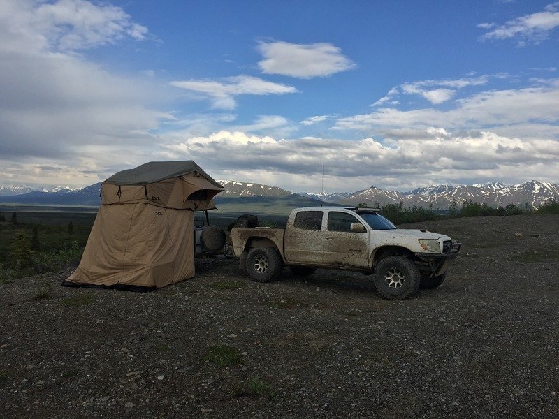

    Bed cage is built to support a removable rack and roof top tent.
    Bumpers / Protection

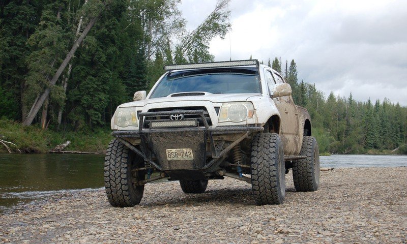

    1 3/4'' DOM Tube front bumper (home built)
    Aluminum and steel skids (home built)
    All Pro rear bumper
    Swing out tire carrier; also lays flat for high speed stuff (home built)
    Hidden hitches (front and rear)
    Hidden winch (rear)
    All Pro sliders
    Comfort and Convenience
    Autopage Remote Start
    Wet Okole seat covers
    Heated front seats
    WeatherTech floor mats
    Grom bluetooth and iPod input
    Low profile rifle rack
    Other
    Bremo brake rotors / Hawk Pads
    Stainless extended brake lines all four corners
    1.5" wheel spacers in the rear to even up the track width
    ABS disable

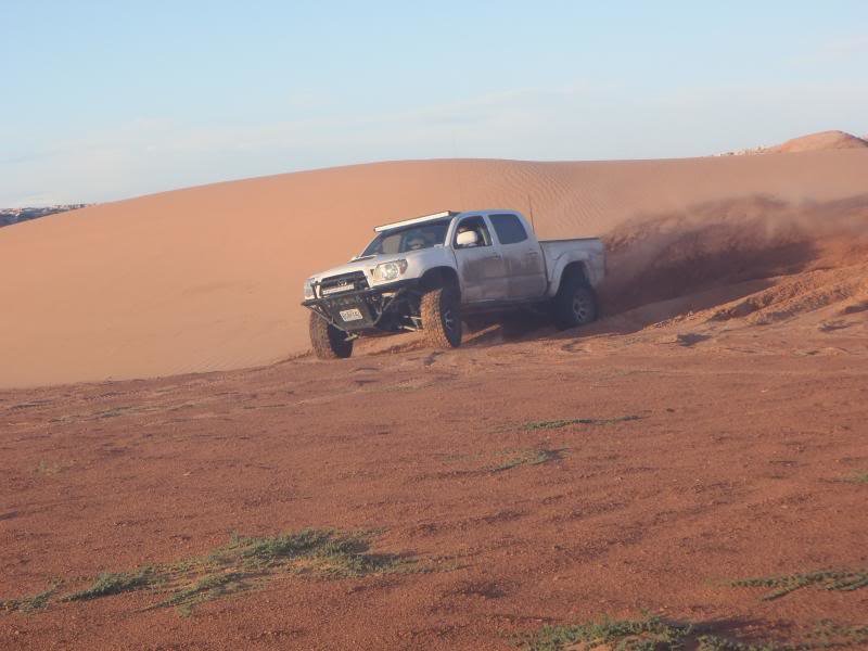

    I love the "Air" pic

    It's so beautiful. Very tasteful mods. How was that landing?

    Landing was good.
    I wouldn't want to go much higher than that, though. Anything higher with my set up would turn more into a "drop" than a "landing". It felt smooth and didn't feel abusive to the truck.
    The rear leaf springs were a new addition since the last time I went airborne. Definitely a huge improvement in the rear; plus the soft sand certainly helps.
