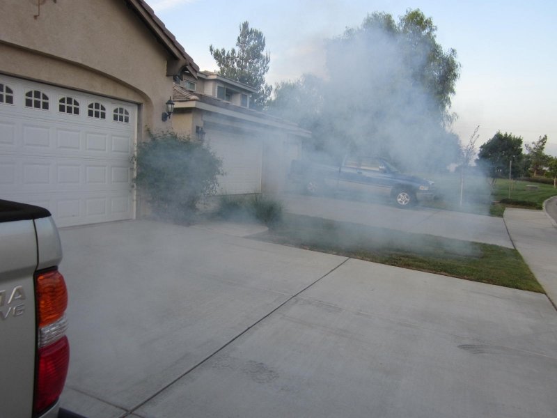

    Gave the motor a Sea Foam treatment today. I used 1/2 a bottle through the vacuum line for the infamous smoke show. I hope the neighbors had their windows closed, oops.
    The other half I poured into the crankcase, which I plan to change after 100 more miles to synthetic. The oil looked pretty clean still for ~3K miles, so it'll be interesting to see if there's any effect.
    Drove around for a few miles until the smoke cleared up. She seems to run better now but, it's too soon to tell. I'll have a better assessment after a few more days.

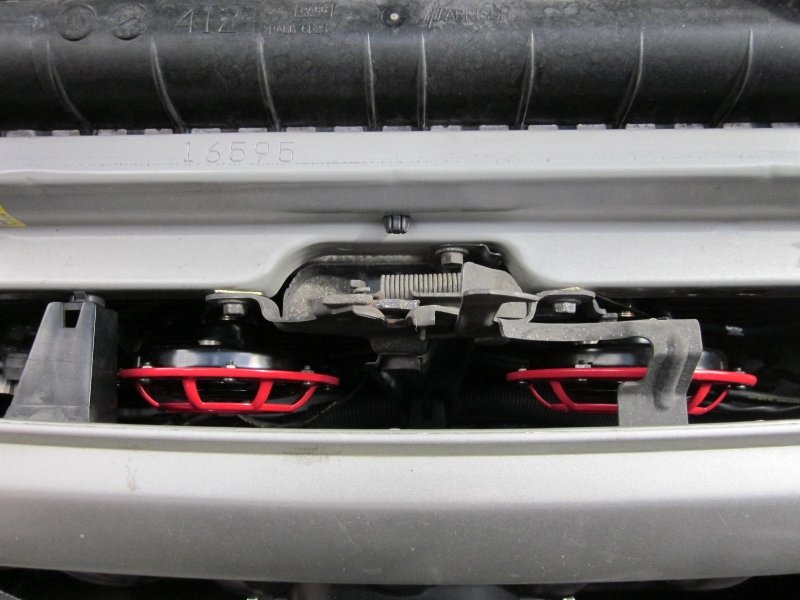

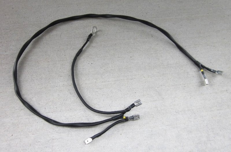

    Swapped out the OEM horn with a pair of Sickspeed 118dB horns (Hella SuperTone knock-offs at half the price). Though not as loud as an air horn, these are definitely an upgrade from the single factory one.
    Custom wiring harness to connect new horns directly to OEM wiring.
    Simple installation of horns (using existing hood latch mounting holes).
    Due to the grill and latch design, this is as straight and even as they'll get (without drilling new mounting holes). In hindsight, I should've gotten them in black instead.

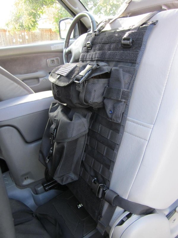

    Belle needed more MOLLE storage, so I ordered another Blueridge Overland Gear MOLLE seat panel and various MOLLE pouches for the passenger seat.

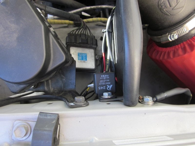

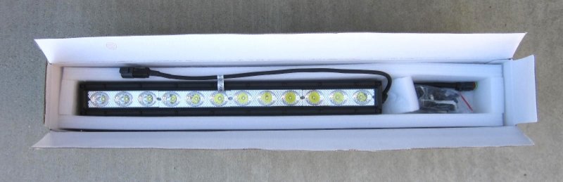

    11/01/13

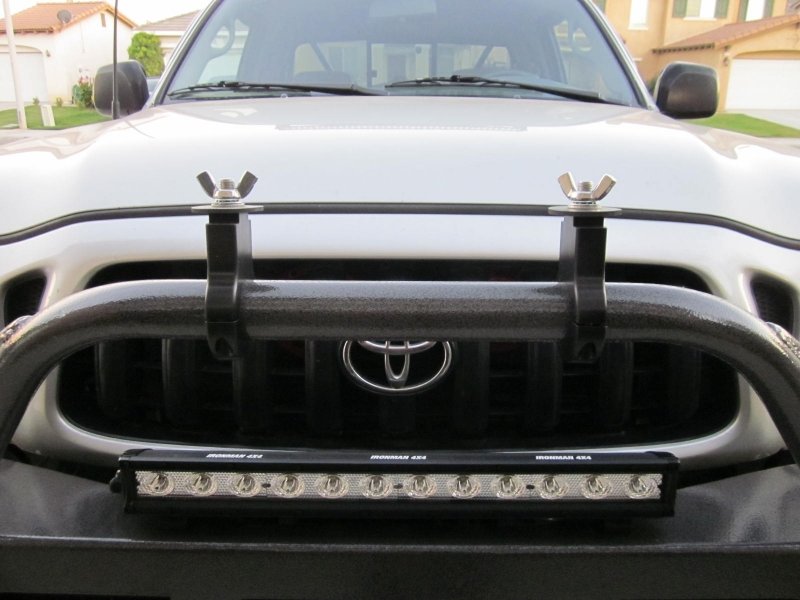

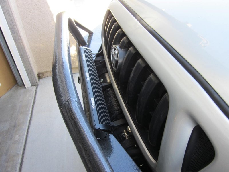

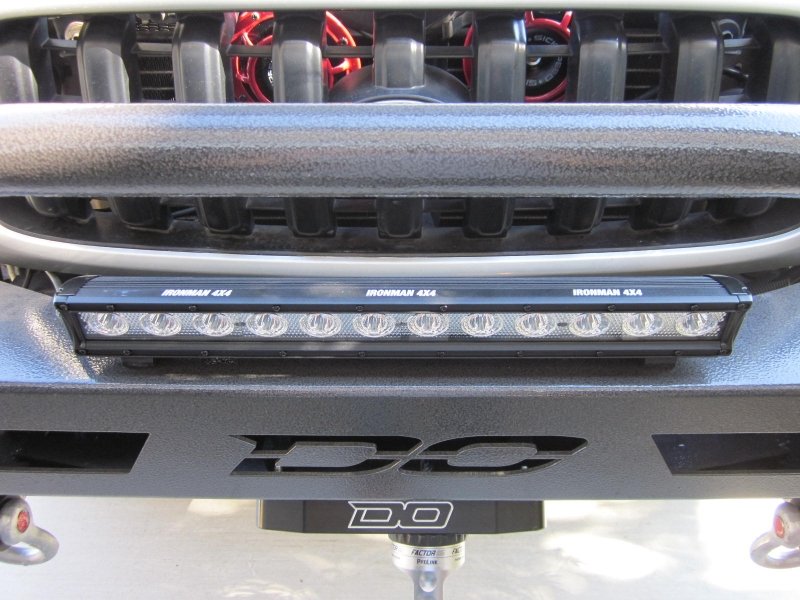

    After 3+ wks, my Ironman4x4 LED finally came in a few days ago. If I hadn't inquired about my order, it'd still be sitting in the warehouse :rolleyes: (someone f'd up the drop ship!)
    Specs:
    • 12 x 5W Cree LED (60W Spot beam)
    • Color = 6000k
    • IP67 waterproof
    • 5400 Lumens
    40A relay for Ironman4x4 LED
    Ironman4x4 LED installed on the front bumper.

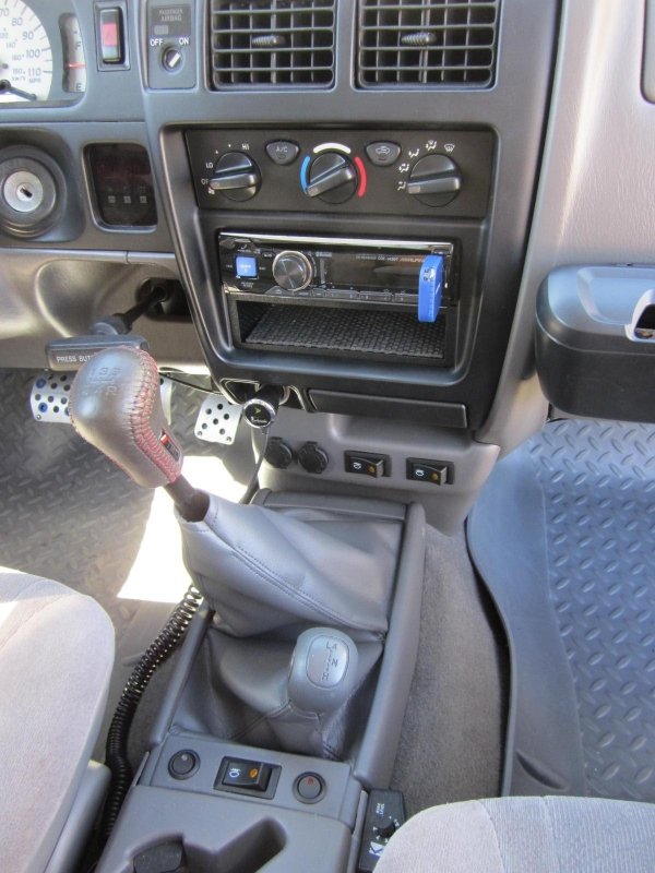

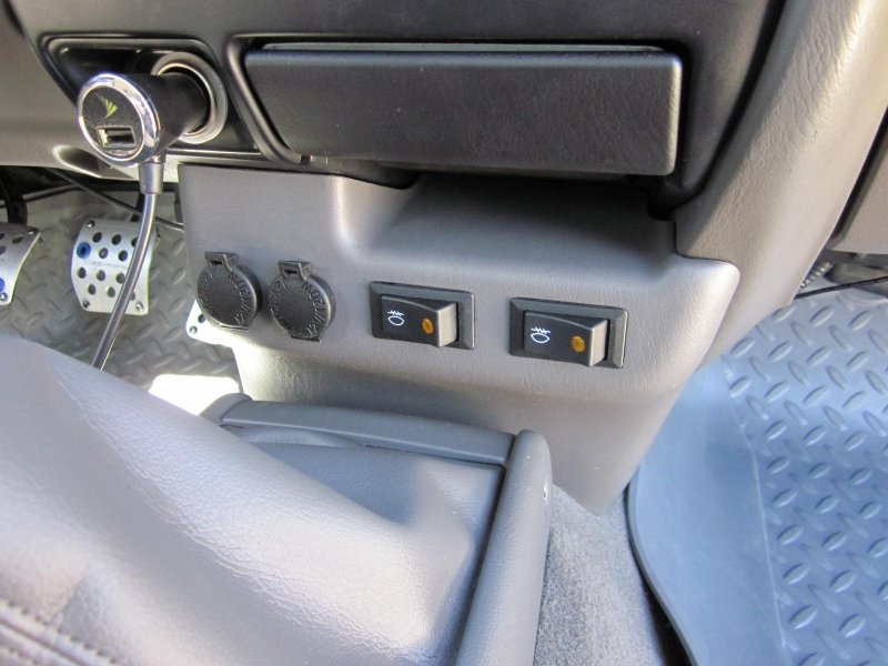

    OEM rocker switches installed.

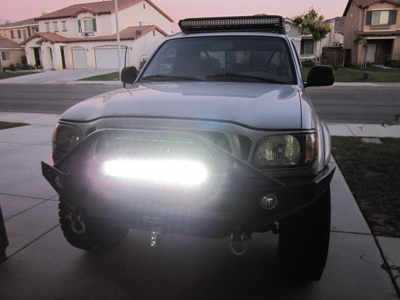

    L - Acro 55W lights
    R -
    Ironman4x4 LED
    Ironman4x4 LED on.
    Lights are all done (for now)! :woot:

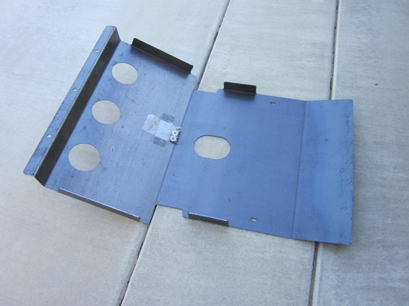

    11/01/13

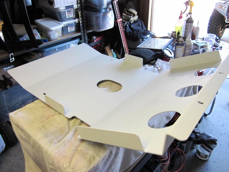

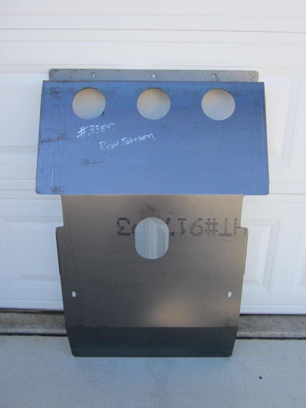

    My skid arrived yesterday - 40lbs of 1/8" steel.
    Sanded with 150 grit sandpaper and WD-40, then cleaned and de-greased afterward.
    Hopefully, primed and painted by the end of the wkend.

    11/05/13

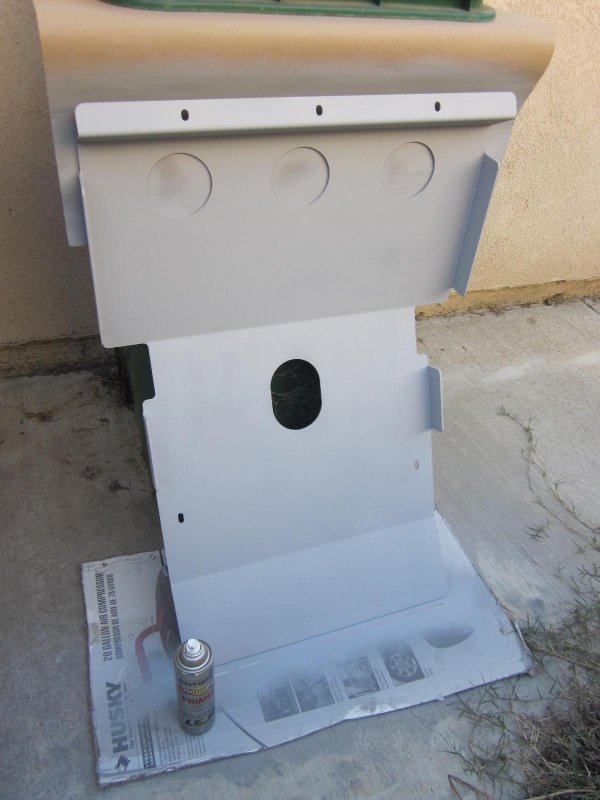

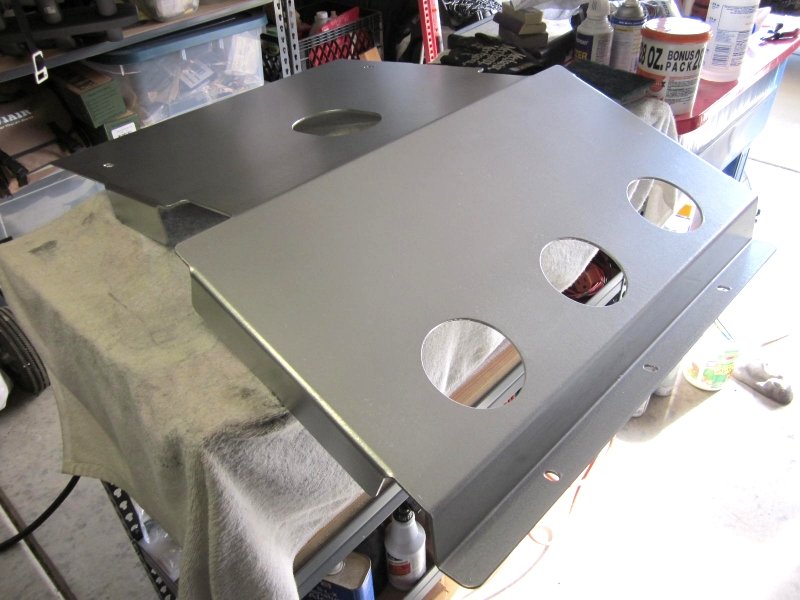

    Skid plate is still unpainted. Priming is taking longer than anticipated.
    After getting high on fumes from trying to spray can it outside...
    I decided to switch to a brush instead. Just one side primed so far.
    The other side should be done tomorrow.

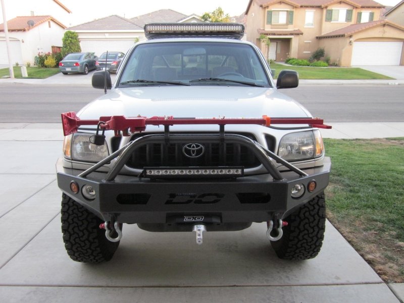

    Meanwhile, my Ellis Precision Hi-Lift mounts finally came in from Canada.
    With Hi-Lift - to prevent theft, cable (not shown) and lock will be used to secure it to the bumper hoop.

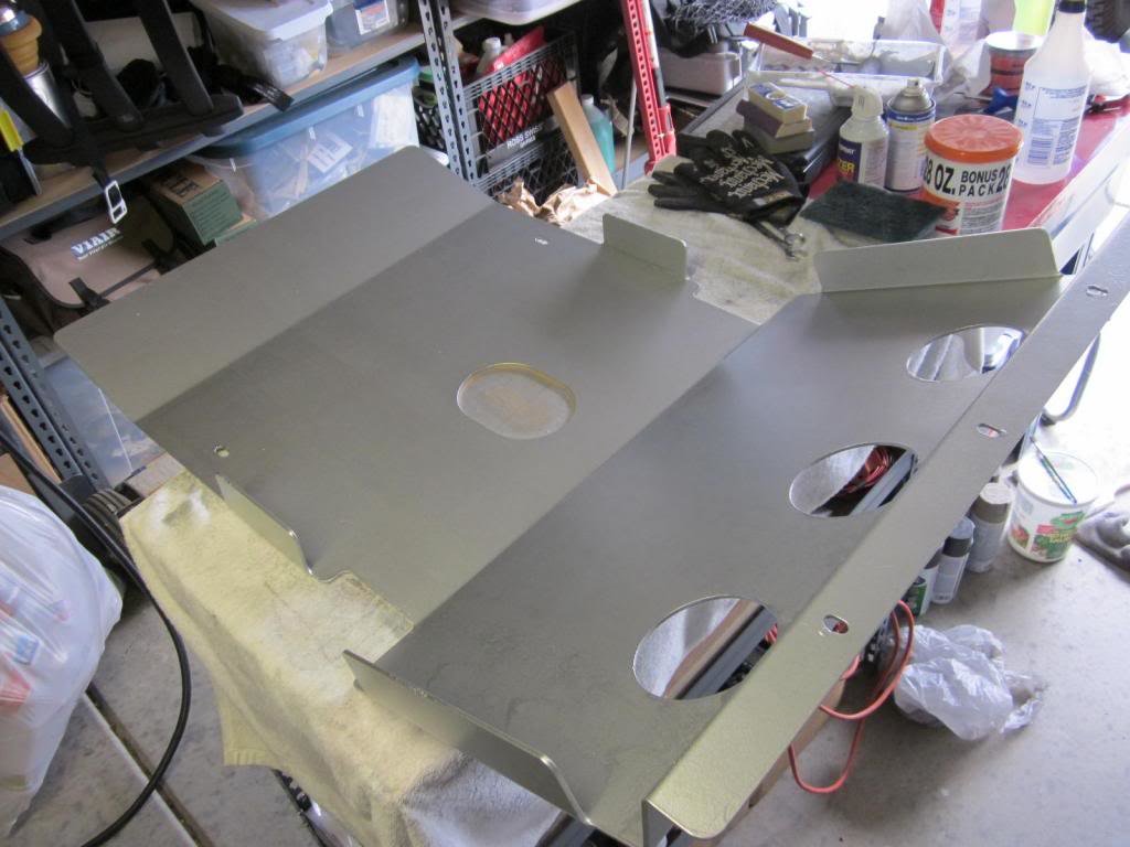

    11/10/13

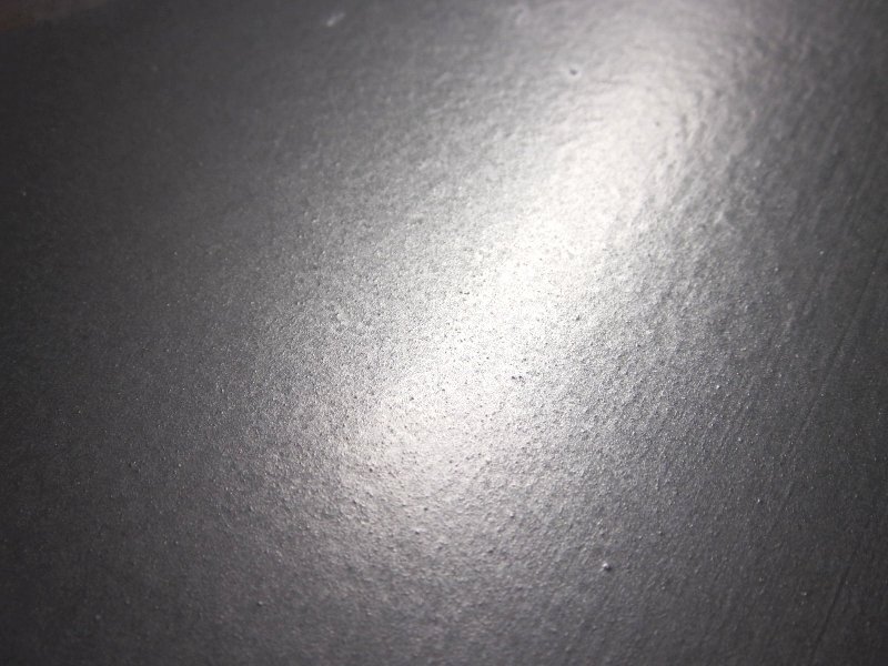

    After four days of more paint fumes (five, if you include the last day of priming), the skid plate is finally painted. Instead of the usual boring black skid plate, I opted for silver this time (actually, aluminum).
    Two coats of Rust-Oleum metal primer and two coats of Rust-Oleum enamel paint, with some sanding with 000/0000 steel wool between each coat.
    After switching over to a brush (from spray can), I then switched again to a foam roller...which I then realized was much faster and with better results.
    No more roller marks, once I figured out the right ratio of thinner to paint.
    A coat of latex clear coat will also be rolled on, once paint is completely done drying. If all goes as planned, I should be able to install by the end of the wk.

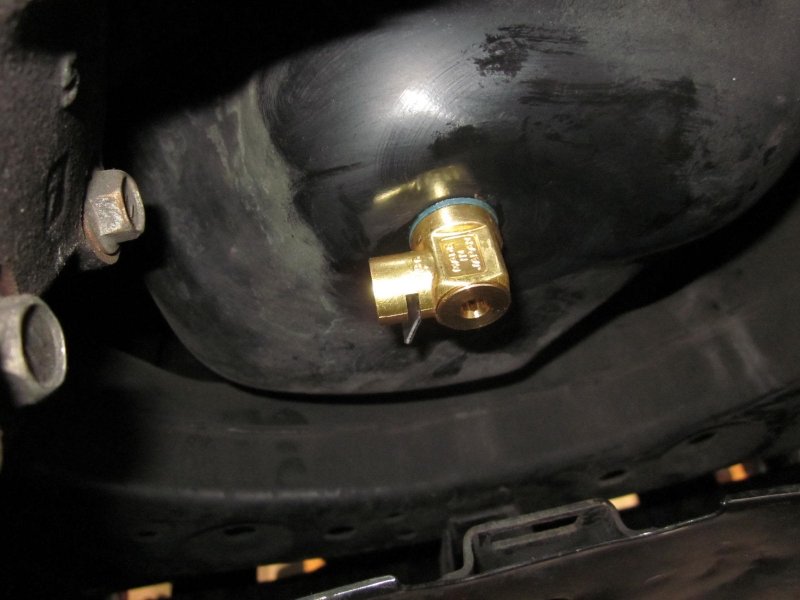

    Meanwhile during a break from painting a few days ago, I changed the oil. Not even 3K miles yet since I got her (~2650 miles), but definitely time to change after adding Sea Foam to the crankcase (~120 miles ago).
    Drained and filled with 5.5 qts Mobil1 Extended Performance 5W-30 synthetic and an OEM filter. Also, drain plug was replaced with a Fumoto F-103 oil drain valve.

    how is that Fumoto working? i just ordered one
  20. Nov 11, 2013 at 12:31 PM
    #140
    deez
    deez [OP] Well-Known Member
    Feb 2, 2013
    #96701
    221
    Darren
    The I.E. - SoCal
    2002 V6 SR5 TRD 4WD
    Too many to list
    So far, so good. I like it. Just ordered the same one for my FJ.
    Drainage will be slower (vs. drain plug), but much easier (with less mess) to change oil.
    All I need now is a 5/8" hose clip to lock the lever down.
    ETA: 5/8" was too small, I went with an 11/16" hose clip instead.
