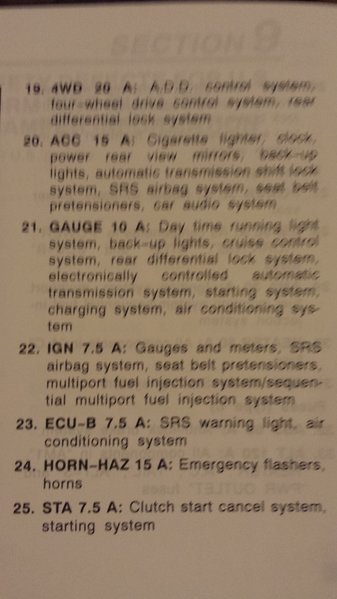

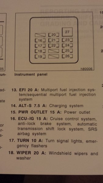

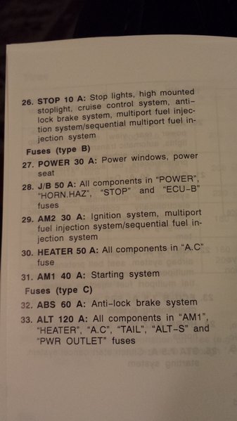

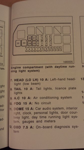

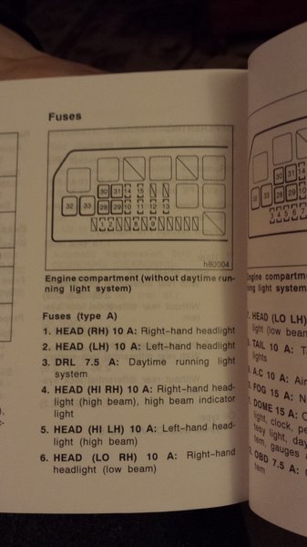

    it would be on the covers. This is from my owners manual.20161027_224120.jpg 20161027_224058.jpg 20161027_224017.jpg 20161027_224043.jpg 20161027_224052.jpg
