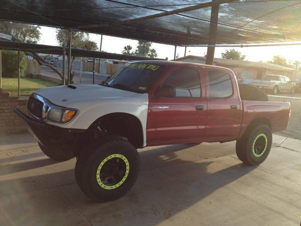

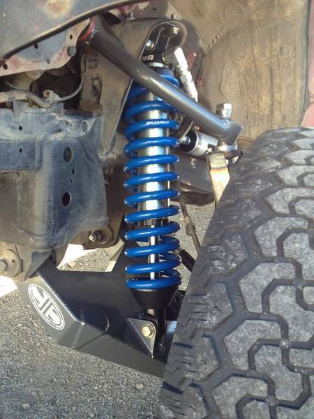

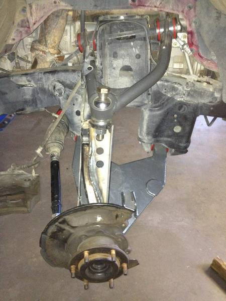

    Today is the day.... JD Kit will be here today and King Coilovers tomorrow so install is set for friday night :) Ill post pics of kits tonight and install pics too.
    @jblaze I am gonna run the JD Kit with Total chaos gussets on factory spindles for now. But when I get the extra money I will be getting the all new JD Fab full fabbed spindle that they just finished ($1300 for spindles and $400 for lower uniball kit). According to Solo motorsports they say there spindles will work with any kit that utalizes the standard tacoma lower ball joint...

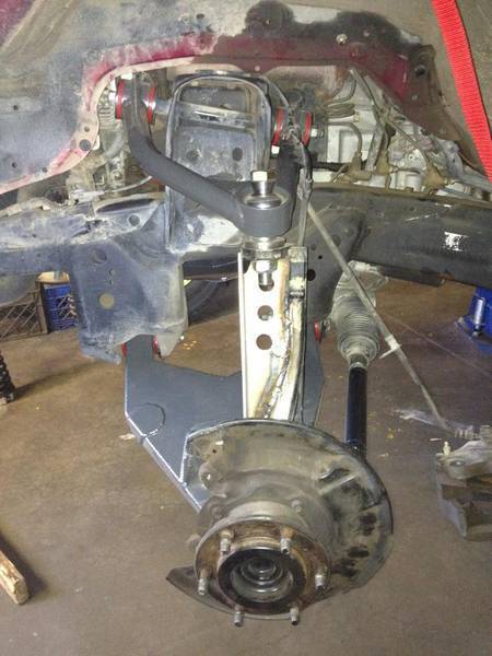

    JD Fab Long Travel Kit w/King Coilovers and Hydraulic Bump stops, Deaver J59 Springs, Total Chaos 9" shackles w/ Icon Dynamics shocks, Glassworks Front Fenders and Hannemann Hood, JR Fab TireGate/Rear Bumper

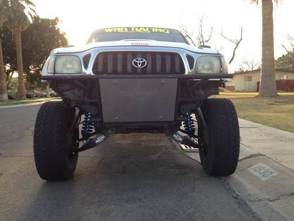

    I guess JD ordered the lower spring plate for a 4x4 6 Lug which is used to clear the axle but since mine isnt 4x4 it doesnt need it.... So the correct spring was installed but the incorrect lower spring plate was put on causing it to lift the truck an extra couple inches..... new plate will be here today so I will post new pic tonight of actual ride height!!

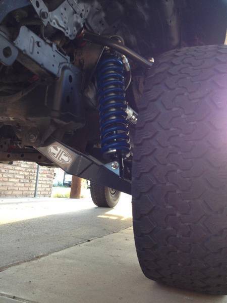

    It rides like there are 4x4 boards instead of shocks..... i think the only thing for suspension is the tires lol aint gonna fly

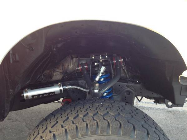

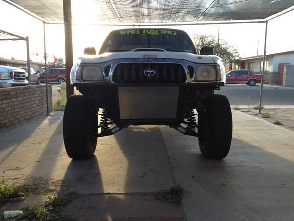

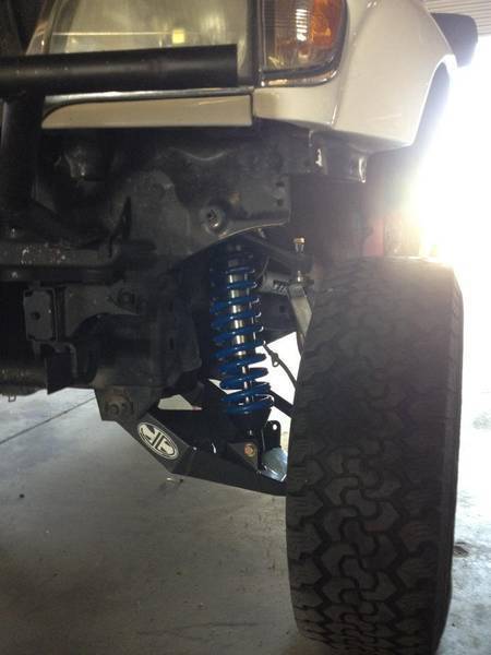

    Got new lower spring plate on...made a huge difference and rides like a dream now!! Also got aligned so only things left are bump stops, limit straps and Steel braded brake lines :)
