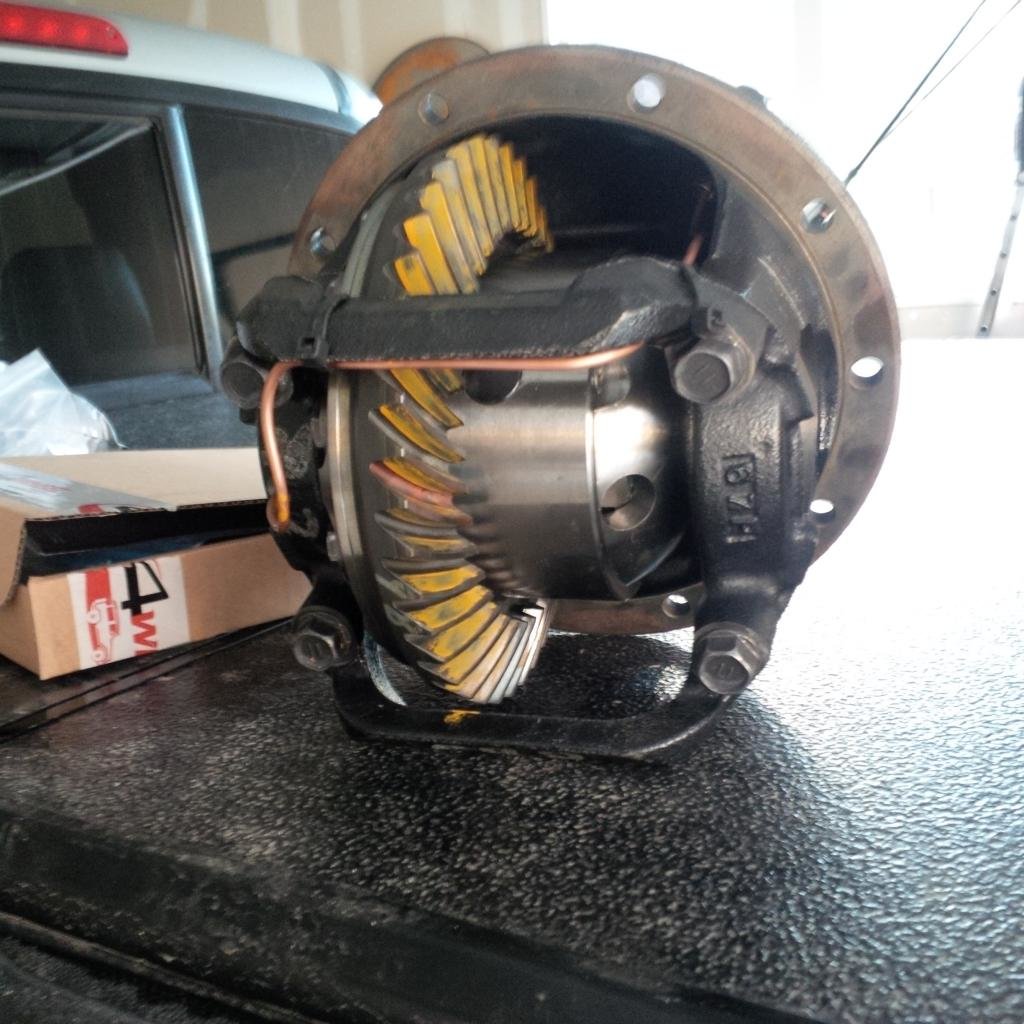

    Started by picking up a used rear axle I believe he is a member or long time lurker.

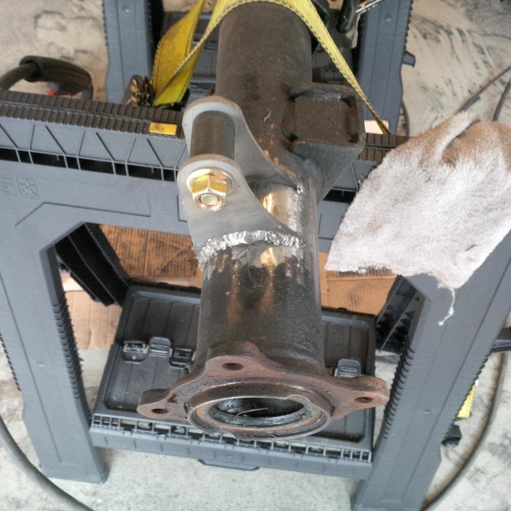

    That last axle I welded up with the shock tabs I over heated causing it to bend. Once again my inexperience got. The best of me.
    I took my time and welded 1/2" at a time while cooling between. Didn't turn out pretty but it works.

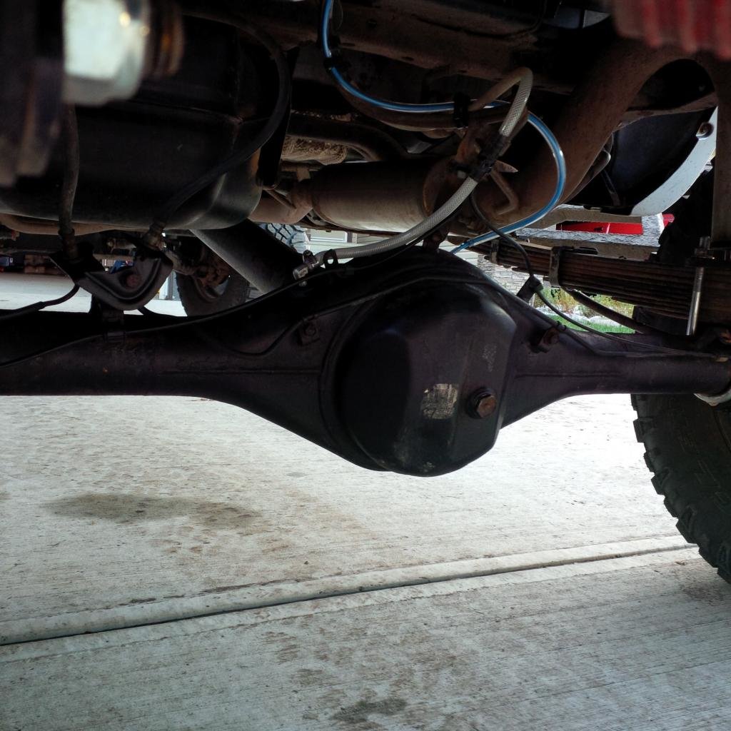

    Axle out

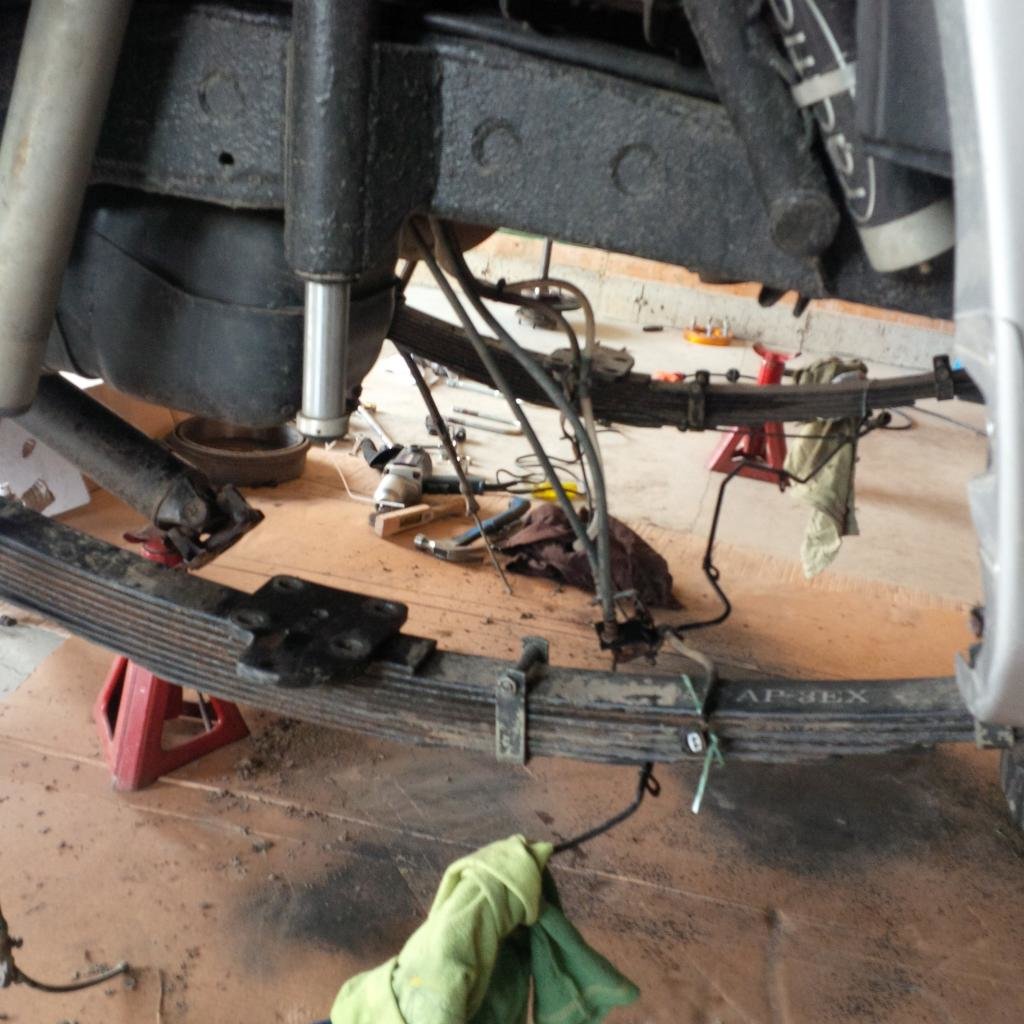

    Axle in.

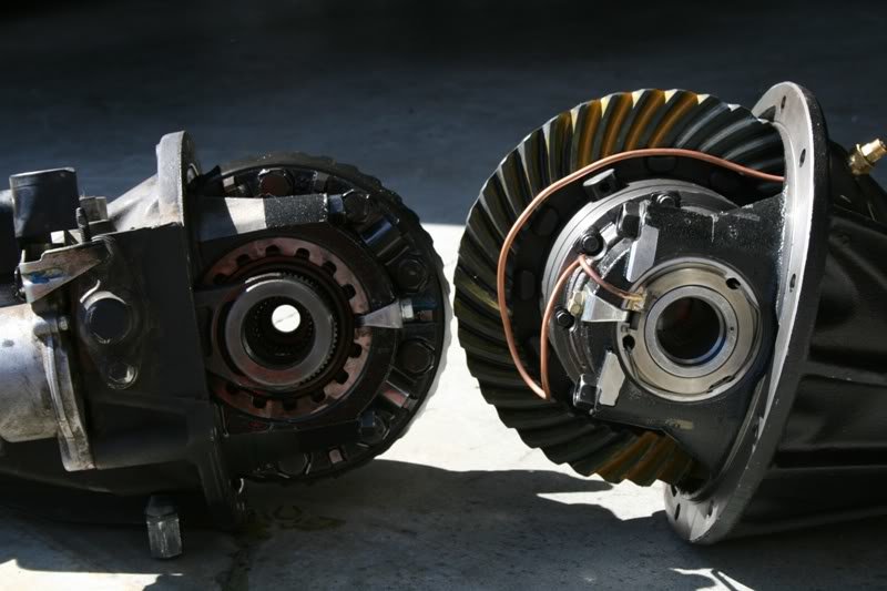

    i bent my axle.....
    sooooooooooooo im throwing the guts of a land cruiser in there :D
