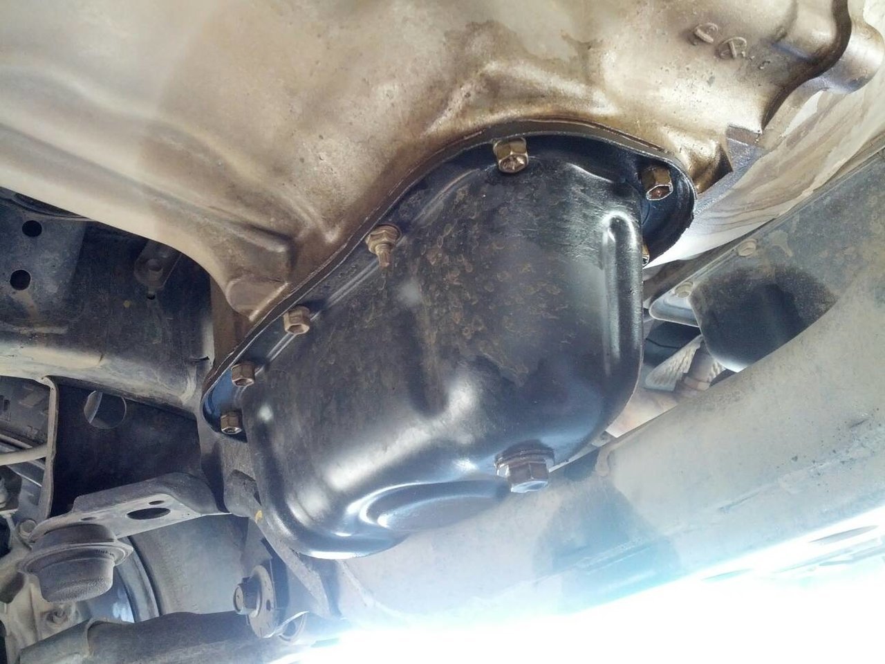

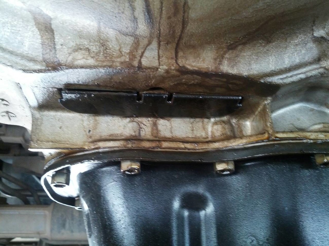

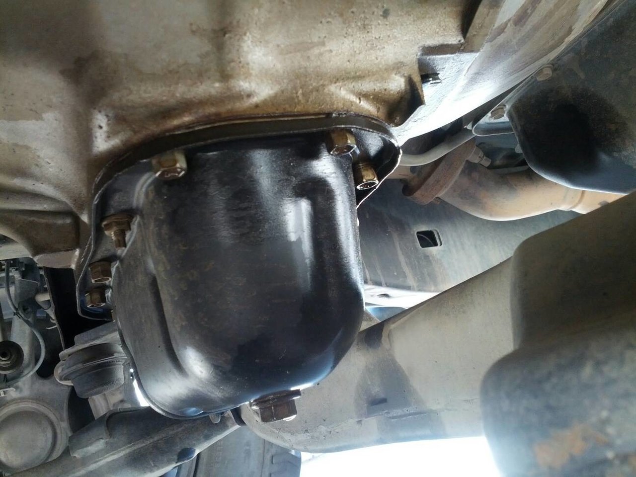

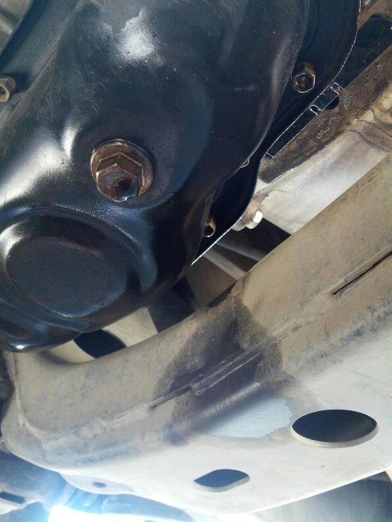

    So just now went to go wash my truck and looked underneath to notice a wet spot around the oil pan. Crawled underneath and the entire pan is wet from the seal down. A small drip off the drain plug. Looks as though its spraying out of the gasket under pressure because their is no leak on the driveway or while its sitting turned off, but it sprayed all the way over onto the tranny area.
    Details:
    2009 4.0 with 49,950 miles. Been using Mobile 1 5-w30 since day one of owning the truck brand new. Last oil change was about 2100 miles ago. Did not use a new drain plug seal, just reused the existing one, BUT it doesn't seem to be leaking from there anyways. Looks like way higher up around the gasket.
    Any ideas would be appreciated!

    Looks like it's coming from above the oil pan.

    You sure it didn't just come from the oil filter catch ring nipple? I know it usually spills onto the lower radiator hose but maybe it made its way down the block?
    It doesn't look like it came from the pan gasket to me.

    From having removed one before and puttin gon a new gasket... That's cheap easy and takes about an hour to drain the oil, clean everything up, put on new gasket and replace. ( the cleaning and drying takes the longest). Gasket should just be a high temp, liquid style that squeeze a bead onto the pan with before tourquing it back into place.
    If its not under warranty I'd suggest doing it yourself to make sure it's done write, especially sense it's very easy to do.
    As to why its leaking in the first place: probably just factory fluke, it didn't get enough gasket on it or something. Look closely at the mating faces of the pan and bottom of the engine block to make sure there's no like dents or anything in either that could cause a bad seal.

    Rear main seal..
    Check where the motor meets the trans...does it look like the source? Or is it looking like the upper oil pan gasket.. either of the oil pan gasket seals are easy to replace but you have warrenty so that's no problem there. My oil pan has residue all around the gasket and many others too, but your leak is pretty significant
    Also for shits n giggles but not likely with this motor..check the heads at the firewall for oil leaks dripping down..

    Ya it is the rear main seal...same spot mine leaked from about 2 years ago...
    I just checked his truck and that's what it is VVVVV
  14. Mar 21, 2013 at 3:56 PM

    mine looked exactly like that too....pretty sure mine was the timing chain cover...so check that....mine randomly stopped lol....it all started when i switched oils.
